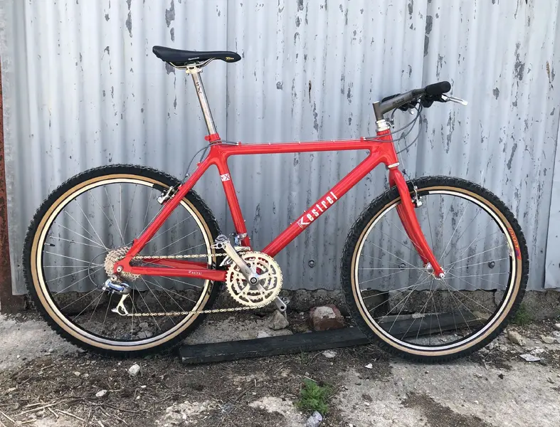

All change here. A good dose of procrastination has made me decide to rebuild the Kestrel. I never managed to really click with the XC Pro, from a functional, tactile or aesthetic point of view.
So as of tomorrow I'll strip it down and I'll rebuild it with a decent usable XTR group. I'll post finished pictures when its down, but it should be top banana.
For me M900 is so dependable, beautiful, classical and so so good. It just works.
So there you go, out with the XC Pro and in the the XTR.

It does just work. Don't get me wrong, XC Pro is lovely, its just not got that special feel to me that XTR does. And i seem to be able to set up XTr really easily.
Rebuild complete with full XTR now. Much cleaner looks and it appears to work much better too. I love it.
New spec as follows:
Spec as follows:
Kestrel CSX frame with original steel fork.
Ritchey Logic Headset with Ritchey Cable Hanger
Fat Bottom Titanium stem
Kestrel Kevlar Handlebar
Suntour Xc Pro Brake levers
Shimano XTR M900 shifter/brake levers
Syncros titanium Seatpost
Flite titanium Saddle (Repro)
Shimano XTR M900 crankset
Shimano BB Un-91 bottom bracket
Shimano XTR M900 Front and Rear Mech.
Crank Bros Egg Beater pedals (modern but what i like to use)
Shimano XTr M900 hubs and skewers
Ritchey Vantage Comp Rims
Panaracer Smoke/Dart Tyres
Shimano XTR M900 cantilever brakes
Shimano XTR M900 cables and housing
Overall weight as it stands 21.9 lbs
So XTR M900 appears to be a chunk lighter than Suntour XC Pro.
This bike is so pretty now, so clean and simple.
