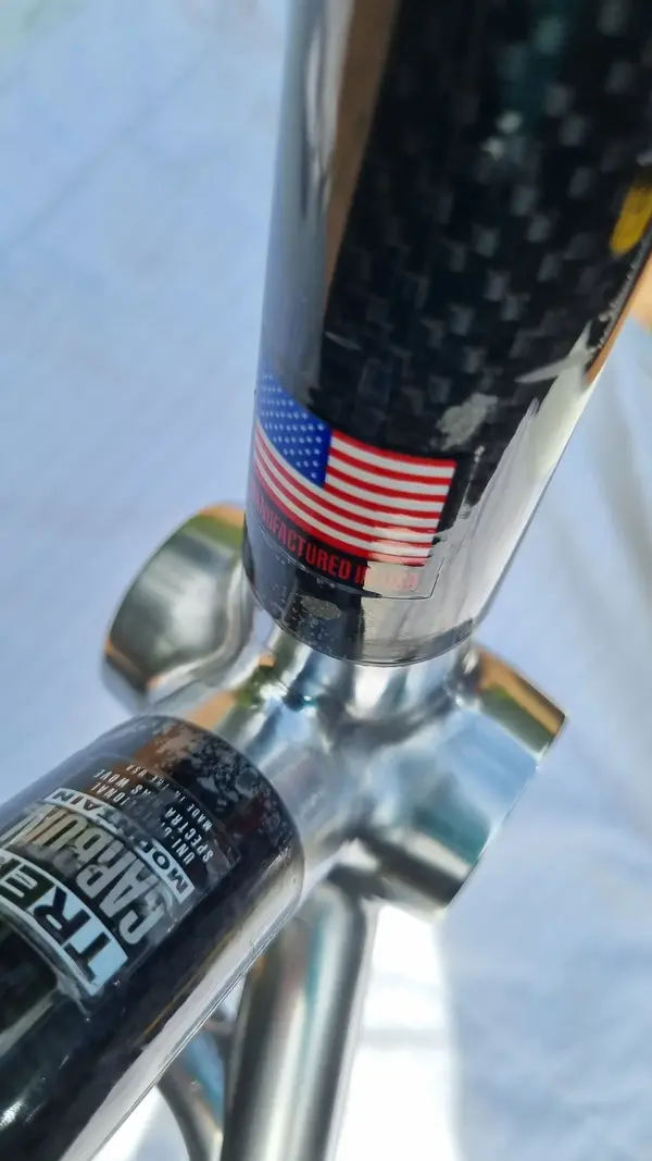

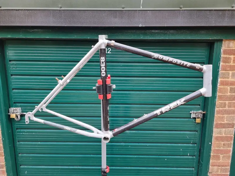

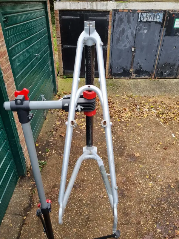

I started the build by checking the carbon tubes as best as could with a camera and no cracks. Phew!

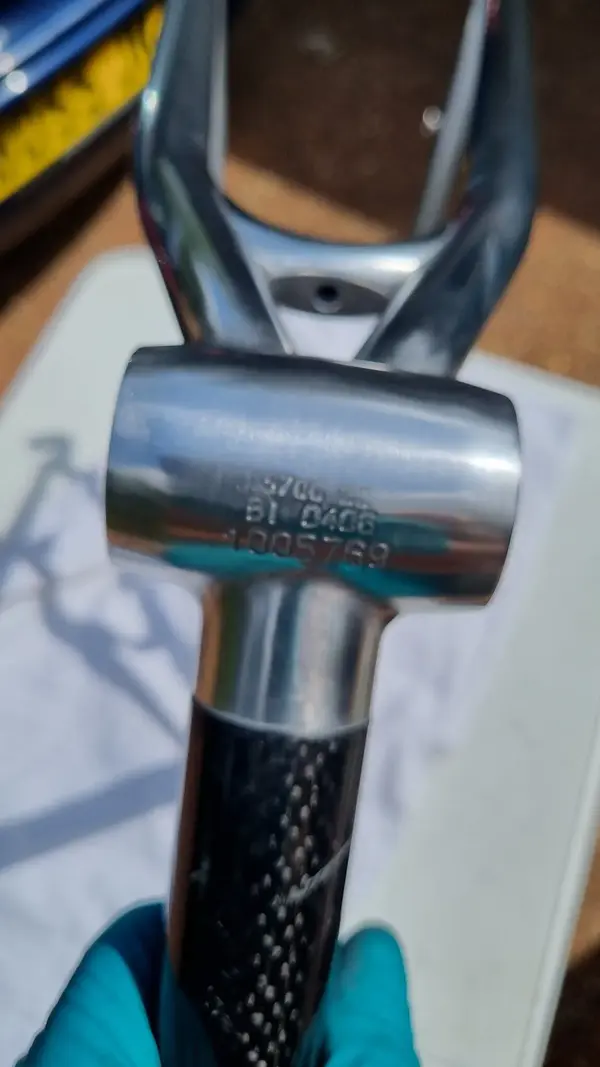

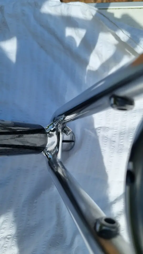

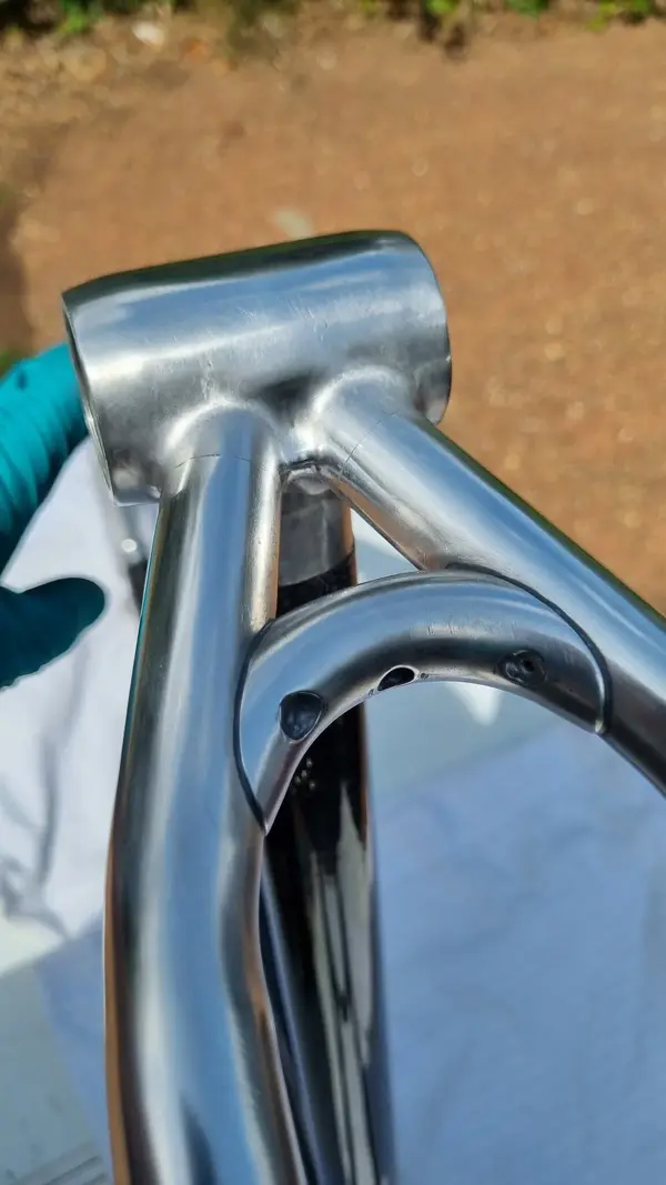

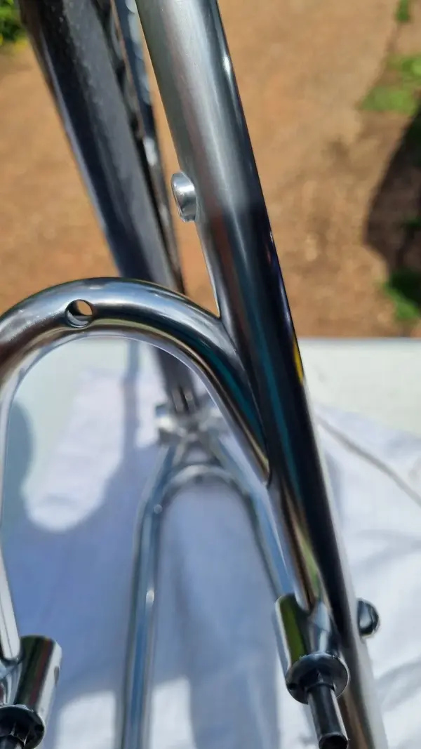

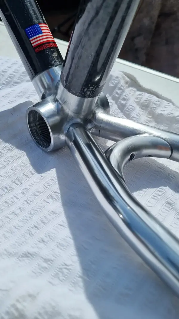

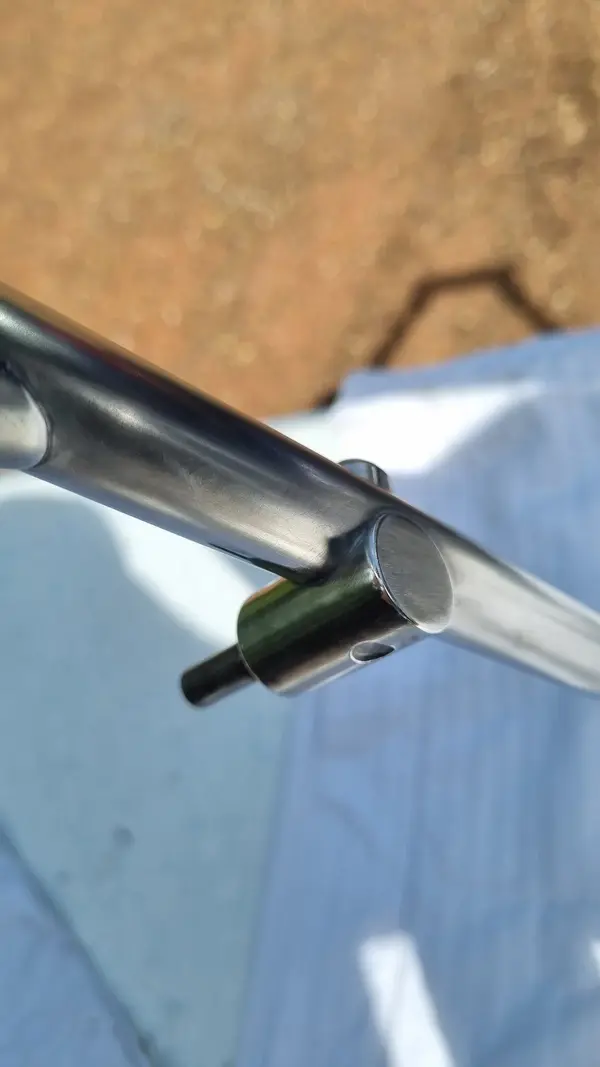

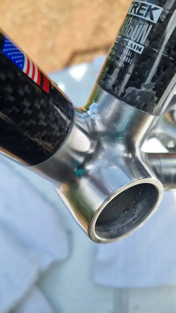

Instead of the flouro or purple route of 8700 and 8900's I wanted to polish the frame. It was my first attempt at polishing aluminium, and I won't be doing it again in a hurry!

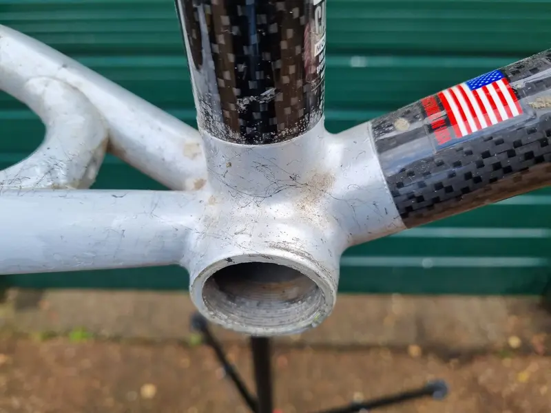

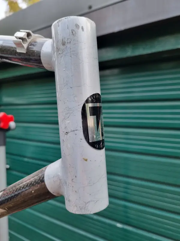

Having taped off the carbon tubing, I went about stripping the grey paint from the headtube, rearstays, and bb area etc. I mainly used 250, 400, 800, 1200 and then 2500 wet and dry paper and used a dremel in the harder to reach places, finishing again by hand. The primer on these frames was no joke and took some serious elbow grease to shift.
It's not perfect, but I'm pretty happy with the result for now.

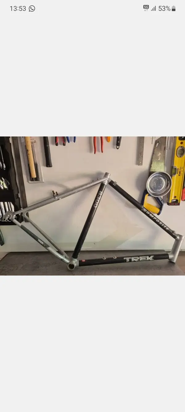

Before:

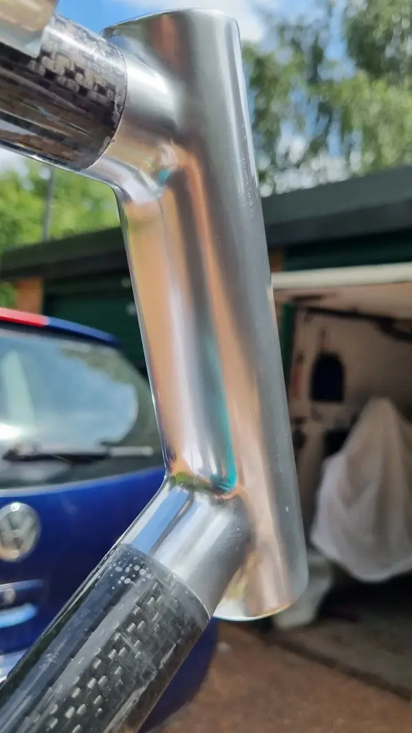

And after...
I may go over a couple of areas again, but it's taken too many man-hours and I need to move on!

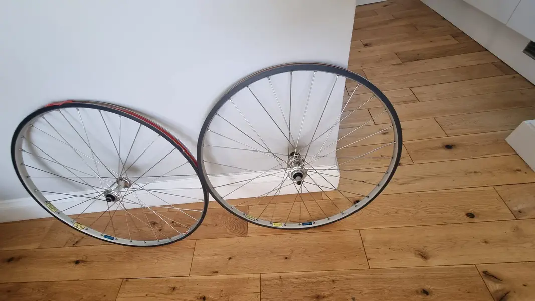

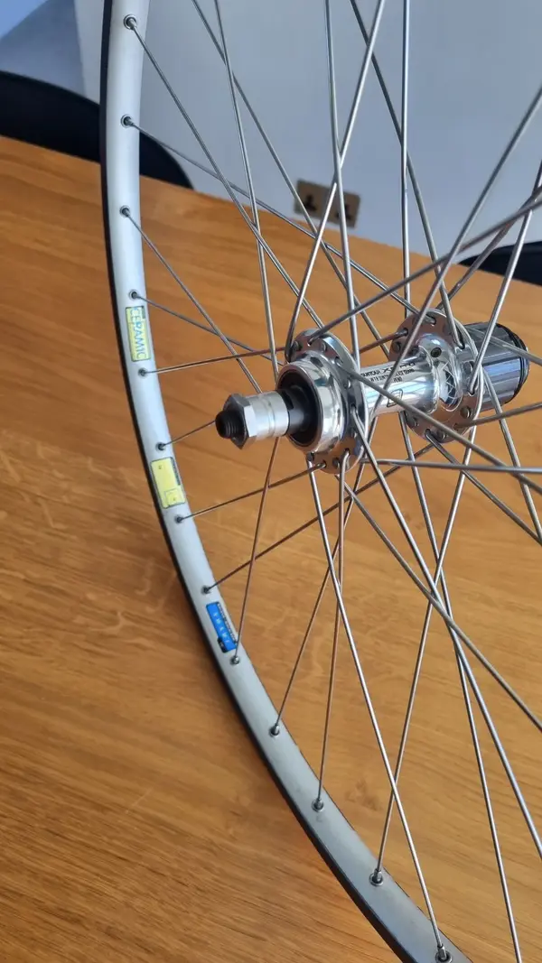

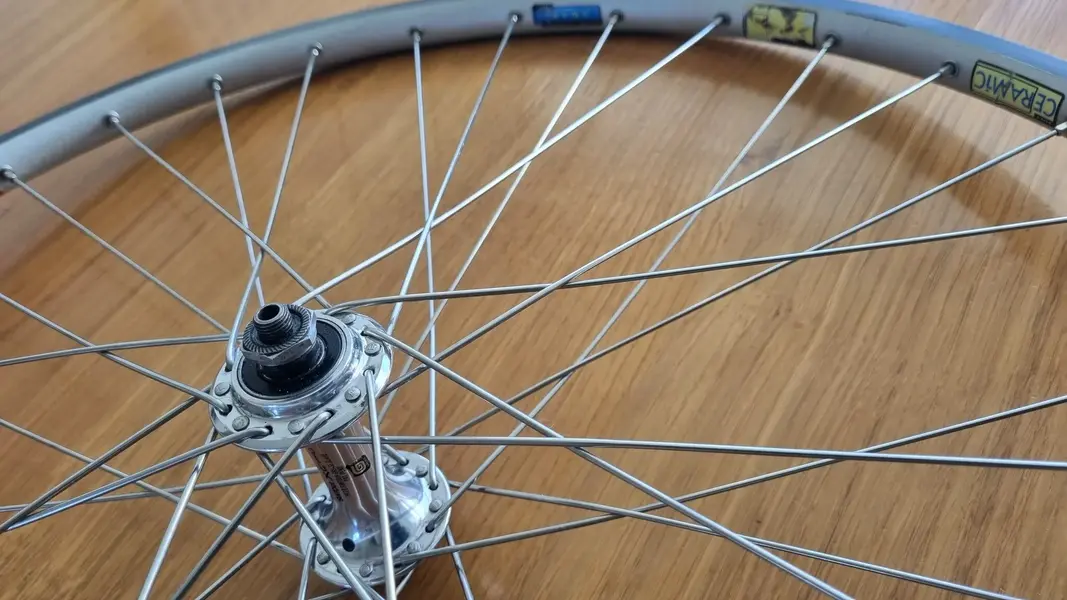

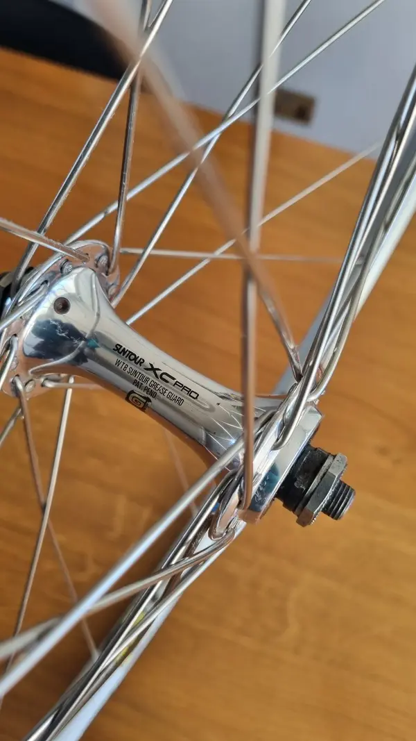

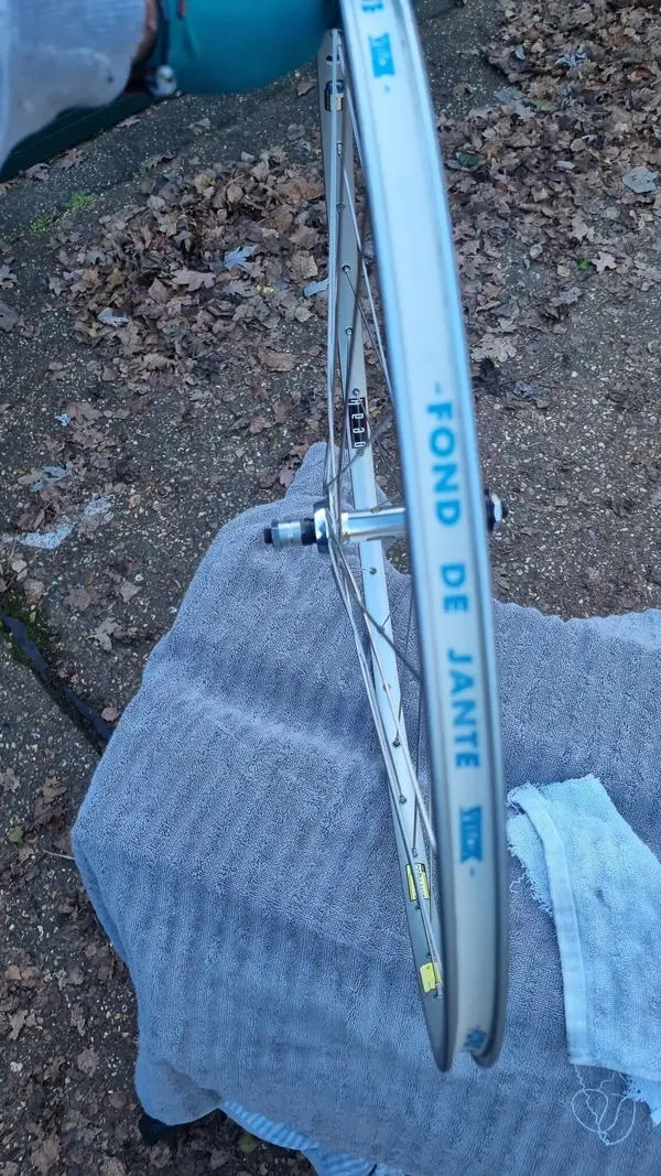

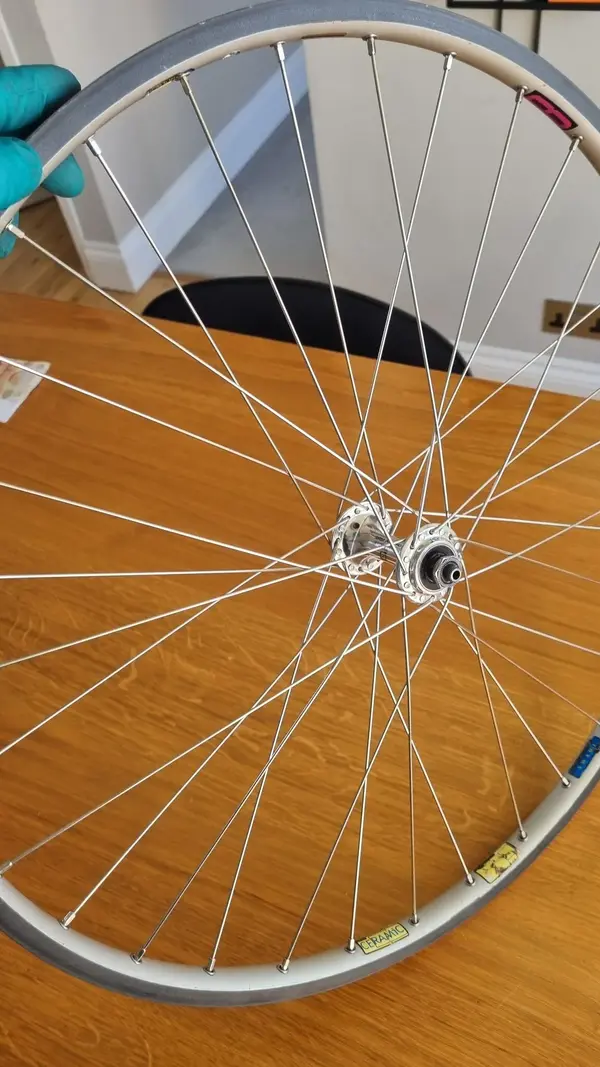

I bought some fairly clean, part ceramic Matrix rims and had them laced to NOS Suntour Greaseguard hubs by Francis Thurmer, who did a fine job.

Yes, the joints are tricky as it's so hard to get the sandpaper into the grooves to make it work. I had to wrap it around various implements, like screwdriver heads for some bits!
