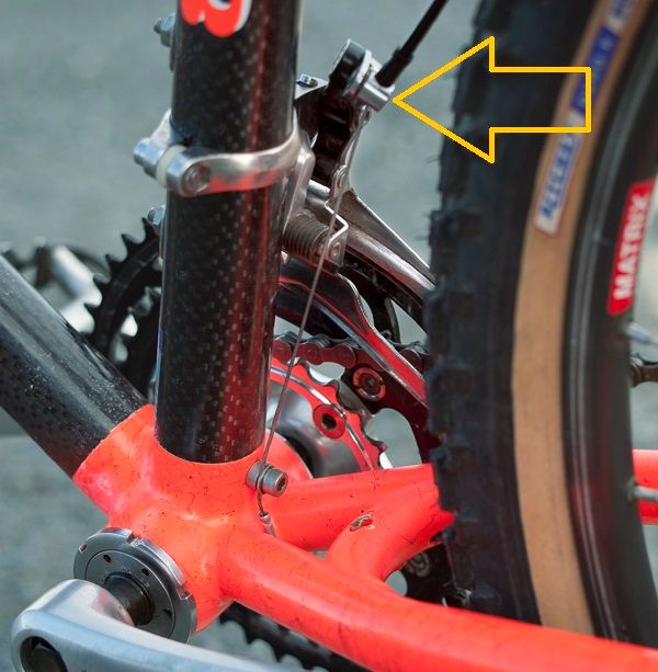

When I saw this frame come up my only reservation was the front mech as these frames have a strange set up on the front mech which is pretty much unique to Treks of this era.
I’ve seen the front Mech referred to as a “Top Push Mech” with a Doohickey fitted – okay it’s strange idea but gets around the problem of using a bottom pull mech with top tube cable routing without the need of a roller. (I beleive top pull mechs weren’t available in 1990/91)
Heres monsieur 24 Pounces fine example
And Here’s a fine example of Anglo Saxon garden shed engineering standing in for the real deal.
Without wishing to come across as unappreciative of Longun “bush fix” I just couldn’t live with the “Rustic look” but so greatful for it never the less as it gave me a good idea of how the set up works. So thanks to Incorrigable (Chester Nimitz) in the U.S I’ve now got this on route from a Genuine 1991 Trek in near NOS condition
Not sure how well this set ups going to work, but I like the idea of having a Top Push Mech with a “Doohickey” - I have to confess to Googling what the word meant :LOL: http://bfy.tw/MJLA

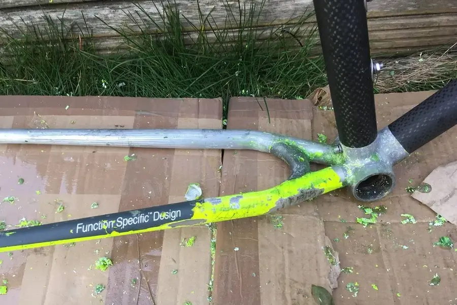

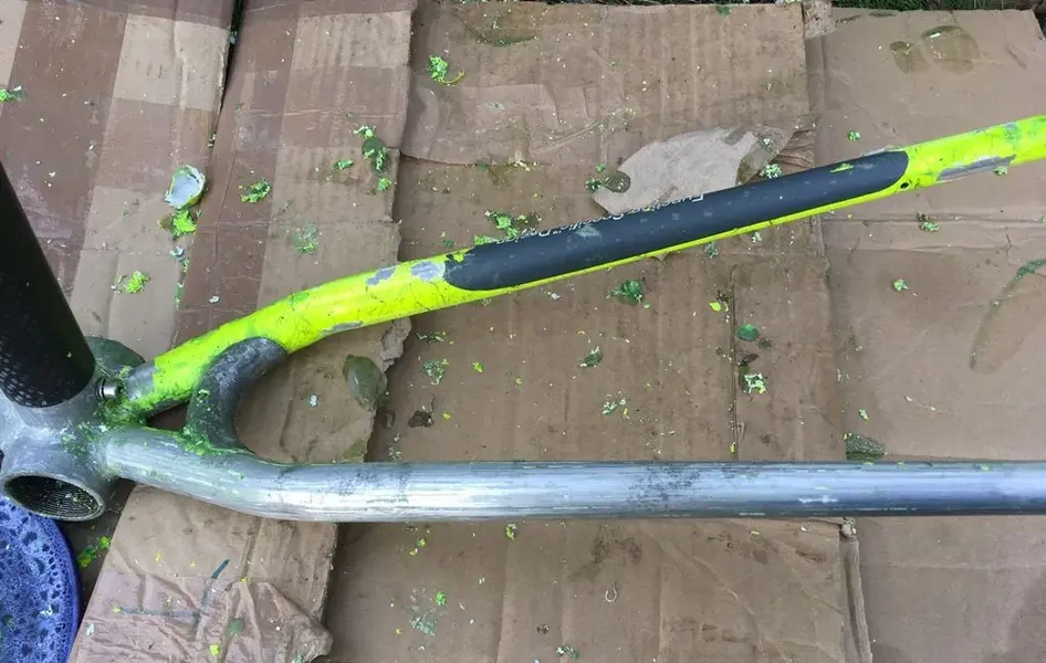

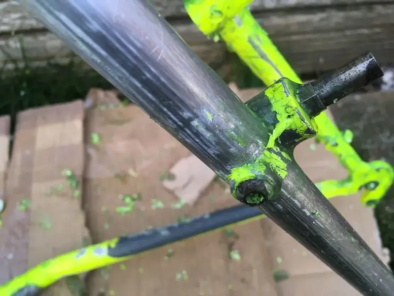

The paint might have peeled off (fell off) around the corrosion but on the rest of the frame its well and truly adhered and super tough – almost to the point that progress is sole destroyingly (if that’s a word) slow – But I’m winning even if the use of Nitromores feels more like I’m tackling the job with one hand tied behind my back. Plenty applied – left for two to three hours and even then the paint still needs gentle persuasion with the use of a Stanley knife blade and wouldn’t simply fall off, reckon Trek used Kryptonite infused Yellow Paint as its only the base coat that melts with stripper
Best part of a tin of Nitromores later and we’re almost there, had I not seen it neon yellow I’d be inclined to polish the bear metal and go super shiny silver and matt black Carbon.

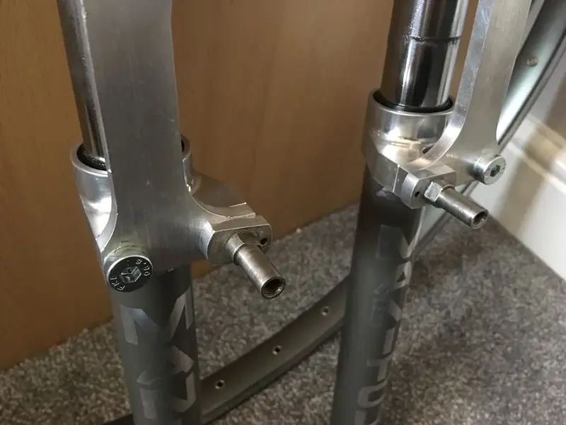

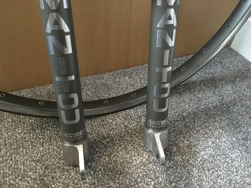

In between stripping I thought I’d have a go at breathing new life into some equally old and period parts – naturally RS1’s up front would have been the way to go, but since this is more of a low budget build using parts I’ve already got, some old Manitou 1's will do as a stand in and period correct substitute.

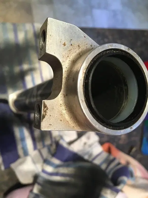

Having acquired these forks with the Yeti Ultimate years ago they were just put to one side and – “from the get go” I was told by the previous owner and curator of a well know Yeti fan website “They are stiff and I’ve given up getting them to work” without too much credence put in those words I spent the next few evenings stinking the kitchen out with metal polish polishing the hell out of them whilst waiting for new elastomers. (although I've missed one brake boss)
And here’s where this story went downhill ………. One Mofo long allen key later I pulled them apart, well actually I had to refit the steerer to remove each leg and pull like F*** to get the out. The melted/sticky mess gluing / holding everything together wasn’t there, only one elastomer had properly gone west the rest were knackered but in one piece
Proper clean and grease up and they went back together but were they tight, as tight as 27.2mm post in a 27.0mm frame, with dinosaur technology going on inside they came apart two or three more times before finally I too gave up - and waved the white flag and posted a plea for help.
and thanks to collective know how and a general discussion on what it couldn't be we got down to what it could be
viewtopic.php?f=1&t=395125
