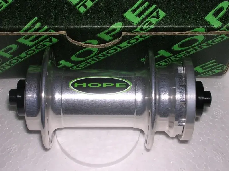

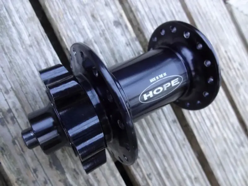

The two axles are slightly different with the later one rotor side projects further, and on the 5 bolt the spacing is even.
Pic of old bulb (5 bolt version) you see that the spacing is even. Does yours look like tis, or does the disc side stick out further as in pic two ?

Thanks Andy you said it better than I could, as I said here are some pics.
Op I think this is like yours (a bulb with 5 bolt spider)
And a 6 bolt bulb (un done a bit)
Axle removed
With end cap for 20mm axle.
Hope that helps.
