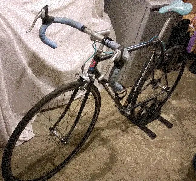

Nearly there, just need to set up the gears properly and take it for a spin.

That's a lot of stem showing, is it an extra long one like a Nitto Technomatic?
Contrasting blue looks nice :)
Yes, I think its a MTB stem, but does the job as the frame is bit small for me really. I have a seat pin push down inside too due to the damage caused by getting remains of old stem out. This one sits over the reduced OD of the pin to make it more secure.

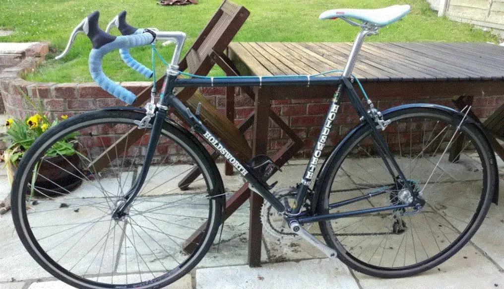

Finished. Took out for 5 mile spin, goes ok, couple of adjustments made when back. weighs in at 11.1kg, which seems a bit heavy, but lighter than with the MBK frame. Not sure i'll see much of a gain tough. Anyway rather ride this than what I had before.
