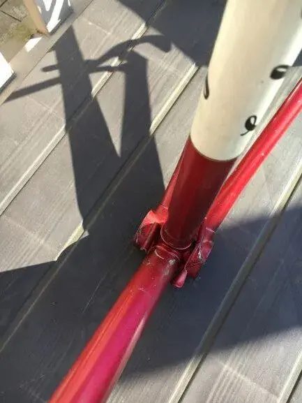

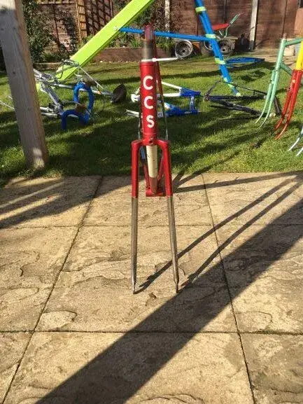

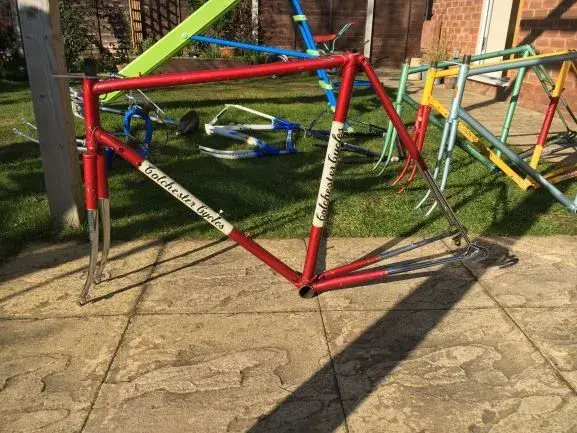

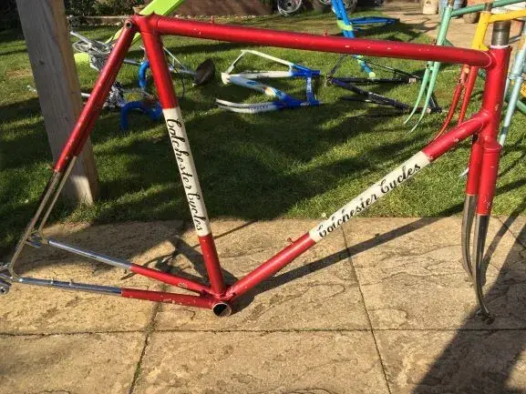

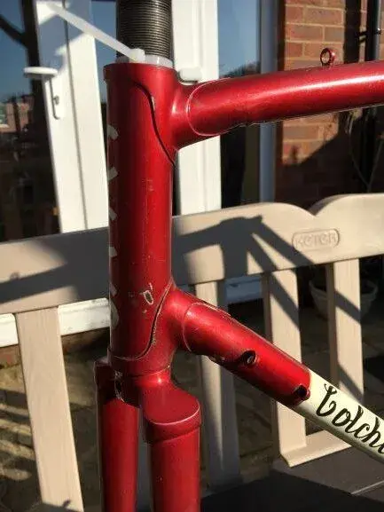

That number would fit the Holdsworth 4 Digit system, but a bit later than the other frame. It also fits with ~1959 CB frame. That does look more probable for the style of frame and fit with observations made by Doug. I guess it is going to come down to who used Simplex dropouts.
It does seem to be the most logical answer that it is a 59 Claud, that have then be modified at some point with mafac braze on's.
It looks very similar to some Cordon Bleu's, with very close numbers. The only difference being the removal of the square nub on the down tube for the shifters and the addition of all the cable braze on's.
Looks likely that the Brev Simplex drop outs were also in use at the time.
I'm not sure how much closer to its origins I can get!
Same lugs and fork crown as my 1962 Cordon Bleu, slightly different semi-wrap over at the top of the seat stays, but I think this changed sometime 1960.
Mine has Agrati dropouts, but as these are only first mentioned in the 1961 catalogue, (we don’t have the 1960 yet) I think it’s not unreasonable to assume they could have been different in '59.
I’d say it’s certainly reasonable to assume a 1959 top of the range Cordon Bleu, at least I don't think you’ll find many who would argue differently... :)
Thank you for that. I guess that's the game really! Search for as much evidence as you can that supports what you think it might be and then wait to be challenged!
All part of the fun!
The only problem I now see is I seem to have a bit a queue forming! 73 Holdsworth, this Claud, a 57 Ephgrave, a 92 Geoffrey Butler and an early number Roberts, not to mention keeping the existing fleet going!
Thank you for your help. I'll keep you updated on progress.
Kristian
Just to add a little more confirmation, the serial number looks to be stamped up the side of the steerer near the crown race.. non-drive side? That's a Holdsworthy trait.. not universal.
This is good news all round. Other than stripping the paint off and finding transfers, i'm not sure I'm going to get any better confirmation.
