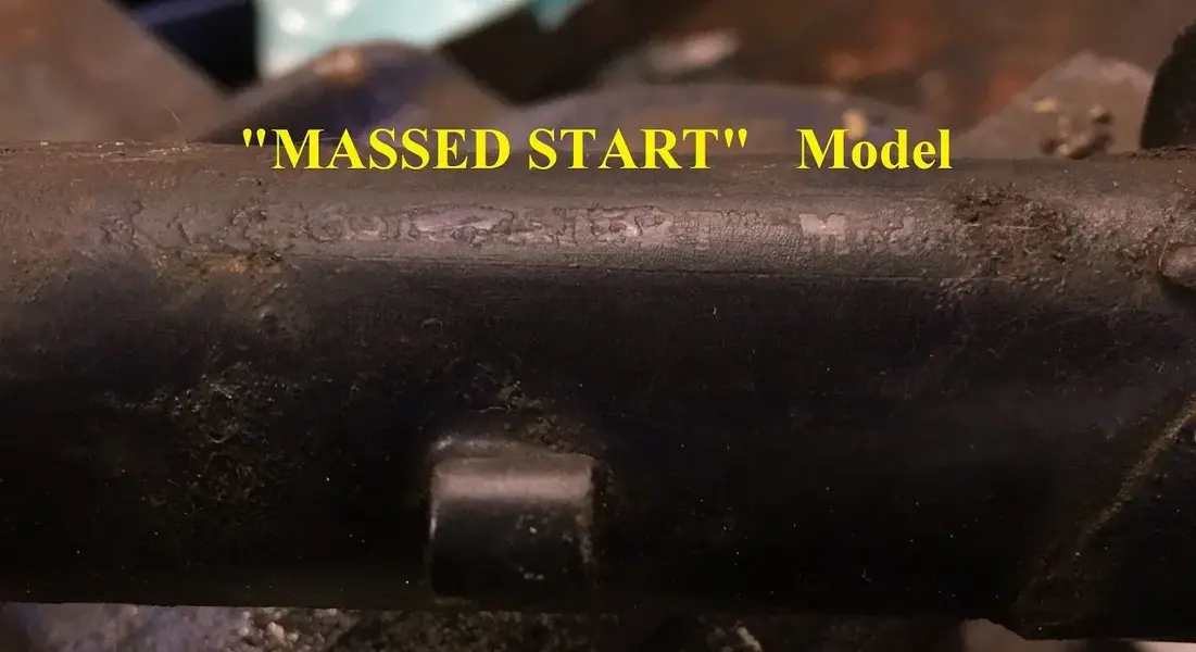

Just to back up what Doug has said, here is a photo of my 1952 Claud Butler Massed Start top tube name decal.
I was going to go straight in with stripping it, but at the last moment decided on a gentle wash first. by luck the remnants of where a decal had once been, reflected light slightly differently and showed very faintly. up until that point I had no idea what it was as the frame had several non-catalogue contradictions....

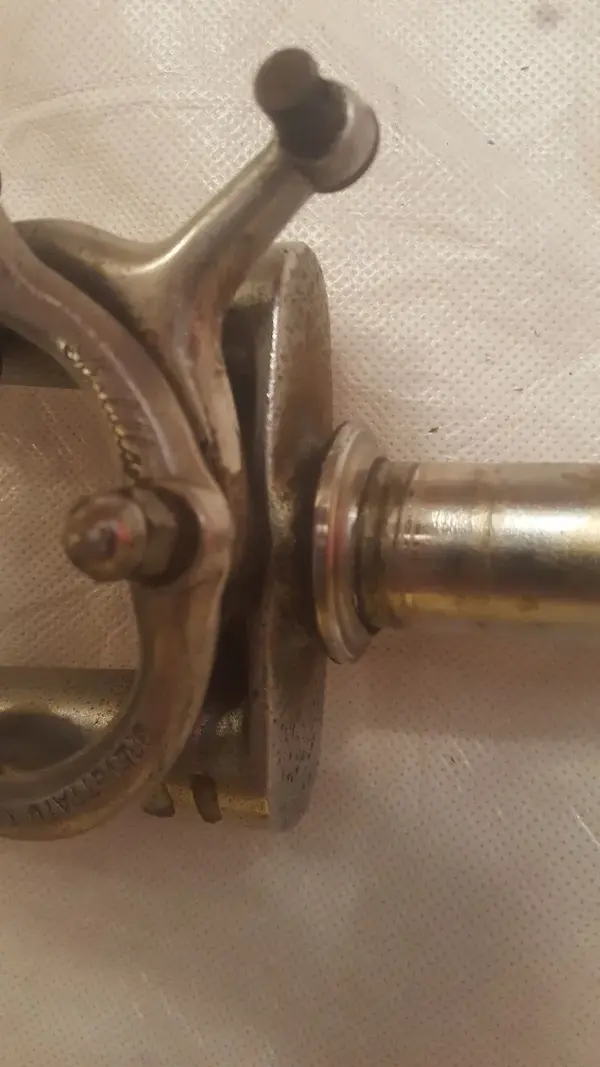

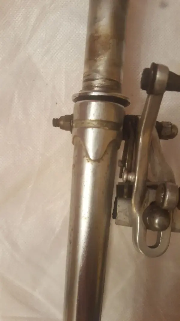

A few more photos if they help with ID not sure

Interesting thoughts on the date, thanks. It's possibly later, I'm probably misreading your charts. Anyway, a couple of pics from the eBay auction (I haven't received it yet):
