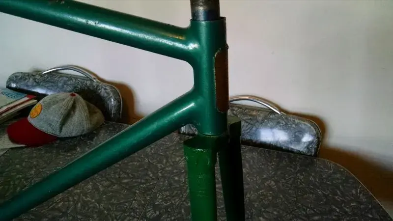

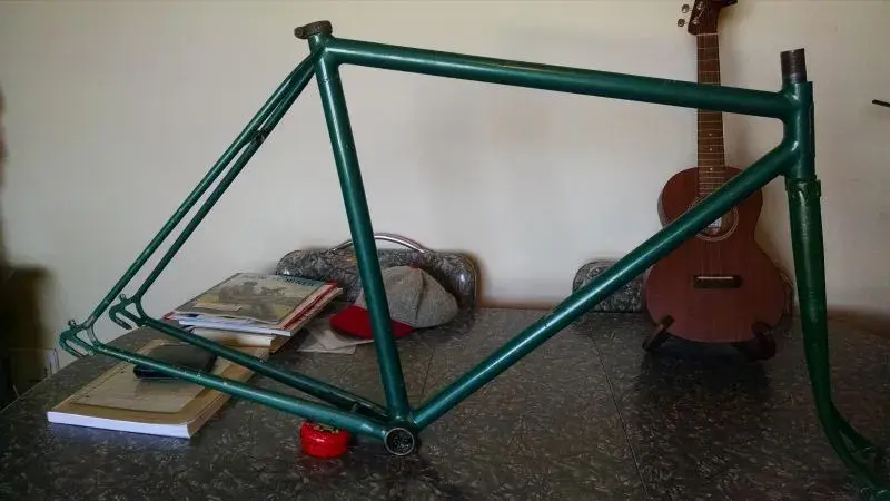

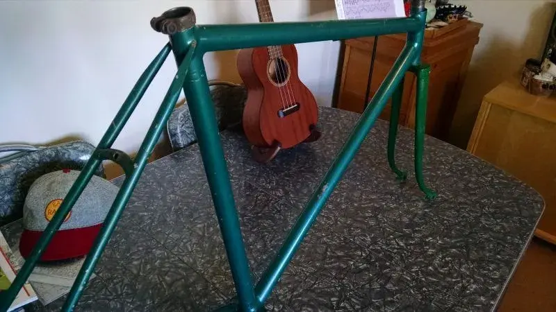

Wolber,
I believe frame 7331 is a 1973 WF Holdsworth, Putney Shop Italia model. Italias were often built by outside contract builders and often for shop stock. ( http://retroride.blogspot.com/2007/05/h ... _1672.html ) Yours may very well be original paint as has usual shop seat stay cap lining. Dave Scrimshaw and I have discussed this style of dating serial in the past at length as well as in other threads and it appears from his data that quite probably outside "Shop" contractors were, as a general rule, using a 2 digit dating code in early 70's where as Roy Thame's main buider Tommy Quick appears to be still using (in 1973) numbers prefixed by 69 and placed along BB edge. Two possible outside builders described by Kilgariff are well respected builders for the "trade" Charlie Roberts and Alec Bird.
If you have an Excel reader and search Dave's data you will see besides factory builds, examples of other shop builds for this period, as well as graphs and prediction table. "Shop" builds are much less common.
https://drive.google.com/drive/folders/ ... TNKZkN4TmM
Doug

I respectfully disagree with Doug on this one.
I'm not so sure wolber's frame is a shop model- I'd expect at least an allen key binder bolt housing if it was?
The only thing I can see preventing that frame from being a factory Super Mistral is the lack of chrome, which is not enough to convince me it's not a Super Mistral..
Re: Re:
I was wondering the same thing. At one time did the shop change from using screws for the Headbadge? This one seem to be held on with rivets.

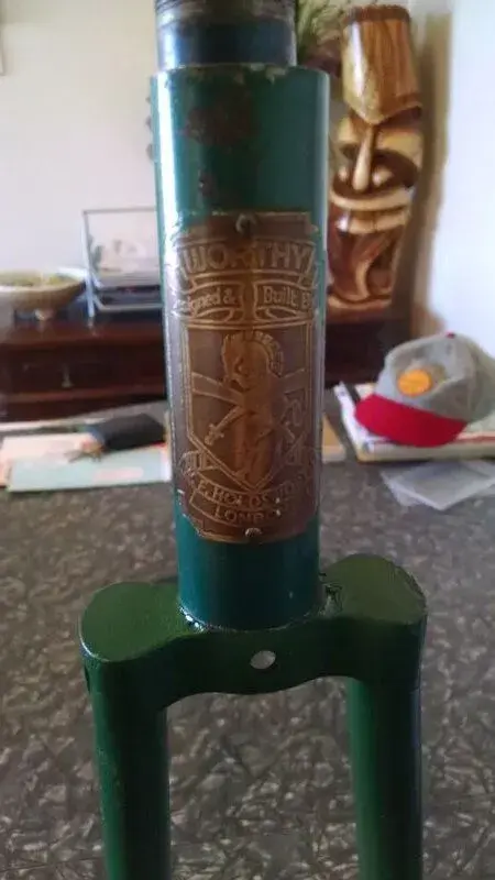

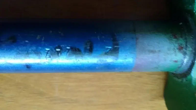

I purchased this La Quelda from Hilary Stone and had it shipped across the pond. It's a 53cm which will be much better for my trike project than the 61cm frame I recently purchased. The serial number on the BB is 7870 and has an H just below the number. This would put it smack into 1947. The fork is not the original fork, but it will do nicely once I get the frame, fork and trike conversion unit repainted. The frame will require a trip to my nearby frame builder Bernie Mikkelsen so he can take the dent out of the top of the head tube and make sure the rear dropouts are straight and aligned.
All in all I'm very pleased. That it's 71 years old leaves me gob smacked to be sure.
Thanks, logged the frame number. Do the forks look like genuine Holdsworth? if so I could use the number, can you confirm as I can't read it from the picture.
Thanks
The forks look enough like Holdsworth forks that I've got no qualms about using them. They probably aren't Holdsworth forks. I can barely read the numbers myself even in a good light. It looks like there's a 22 with a space, then maybe 427? Someone wrote over the top of the stamped numbers with a felt tip pen which doesn't help.
