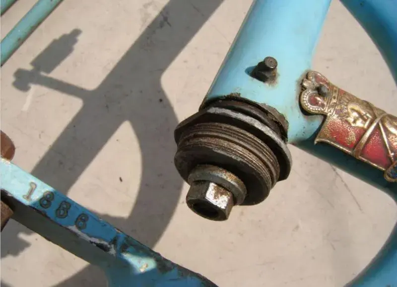

BTW does anyone know how the Holdsworth tricycle conversion units numbering goes? I've got No. 1856 and I'm curious when it might have been made.
Cheers and thanks to both of you.
- Eric

Interesting about the Trike conversion, I have never seen any numbers for these before and wondered how/if they were numbered. I would take a guess, based on how the frame number run, that it is a straight sequential 4 digit number system. As this is the only one I have seen it is a very wild guess. Without additional numbers and some dates to align them to it is going to be difficult to predict. I'll log it away and hope some more come to light.
