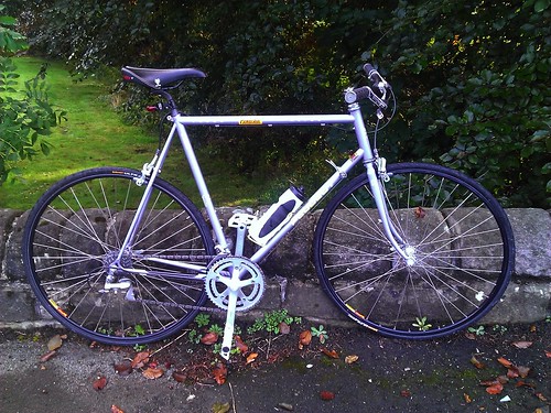

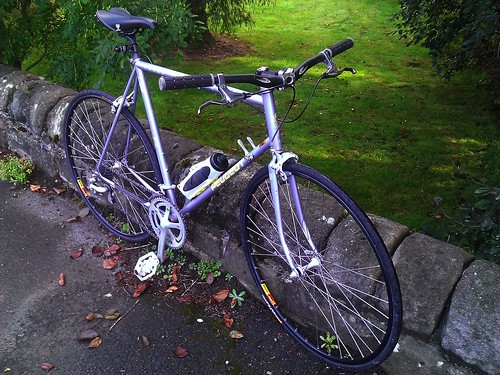

Ok... so here she is after a few upgrades.
New saddle, new brake levers, new tyres, borrowed pedals, stem and bars. Much prefer the MTB bars for better/quicker braking but they are maybe a bit wide. And I'll maybe get some bar ends so I can vary hand position.
as a long time MTBer who's turned to the dark side of skinny wheels (so I'm told by my mates) I can relate to the hand wrist pain. The simple fact for me turned out to be I needed to man up and ride more. My hand/wrists eventually got used to it and now I can flick between flat bar and drops pretty easily. I spend hours per week on a bike so it stands to reason that I'd get aggravation from usually unused muscles when I changed to drops. I had shoulder pain for months until I started back at the gym and it completely went after I built up some strength to hold myself up over the bars for longer periods.
