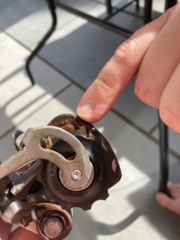

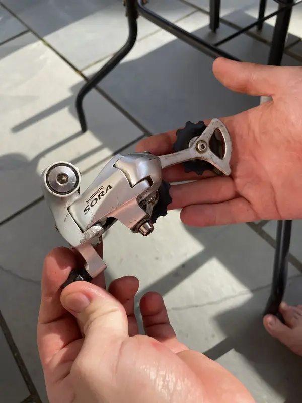

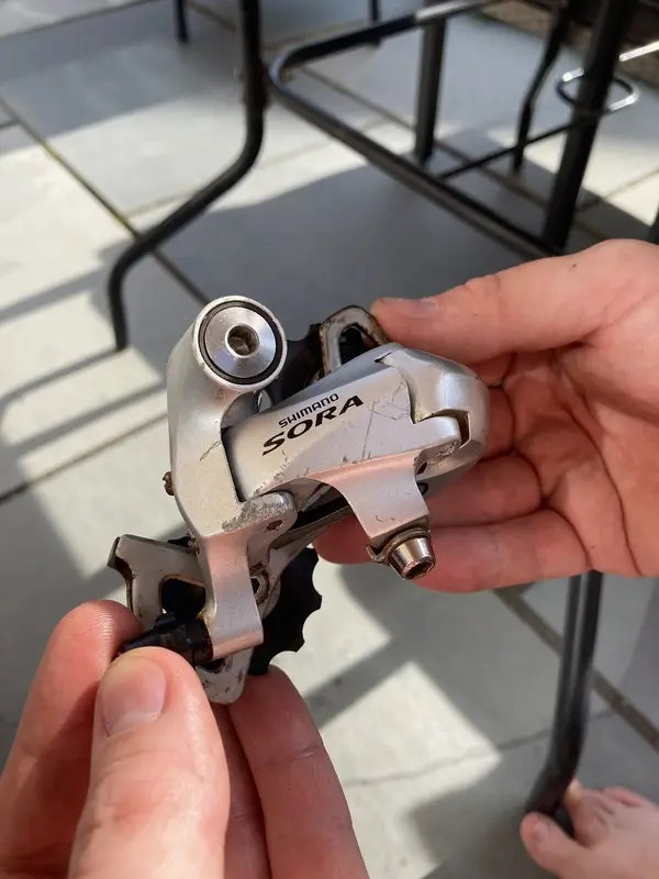

So… finally got around to sorting it, the cage was really sized, as you can see from these images:
Excuse my toes hahaha!
I know this mech is in reality too far gone but I wanted to keep this build cheap as can be… didn’t want to spend the extra £10-20 replacing the mech.
A blast of WD40 and 10 mins of rocking it back and fore and it’s operational again wahey!!

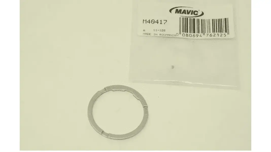

also I’ve ordered a spacer from Mavic which was £5 that allows the hub to take 9speed shimano cassettes I had noticed that the locking nut wasn’t making the best connection (I then made a shim which seemed to close the gap) although I think this spacer is designed for this issue specifically :D
