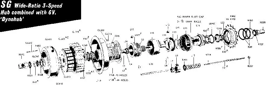

It's a long while since I stripped a dyno hub but I'm pretty certain that the cone should be threaded. If you look at the pic here it looks like the cone would have to be threaded. Thinking logically it would have to be otherwise adjustment would be nigh on impossible.
