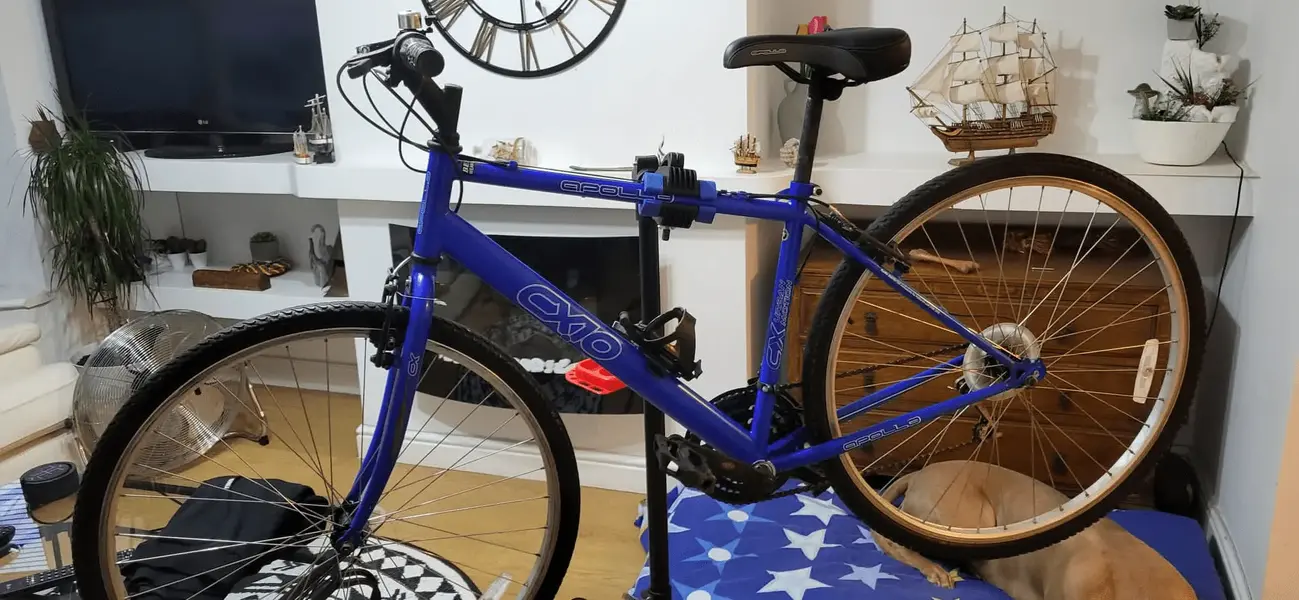

Last facepalms on a bike I bought:
7spd freewheel combined with 6spd shifters (obviously terrible shifts) and an added nut to the driveside spindle stub to compensate for the wider freewheel. Hubspacing therefore 137mm in a 130mm frame. Spindle now too narrow for axle nuts, heyho just remove the washers so the nuts can eat into the dropouts. I WONDER WHY THE HANDLEBARS MOVE EVERYTIME I BRAKE HARD? SOD IT LET´S CLAMP IT DOWN EVEN HARDER. (Stem had swarf trapped from thread cutting 36 years ago, never removed.)
BECAUSE I´M A PROBLEM SOLVER
