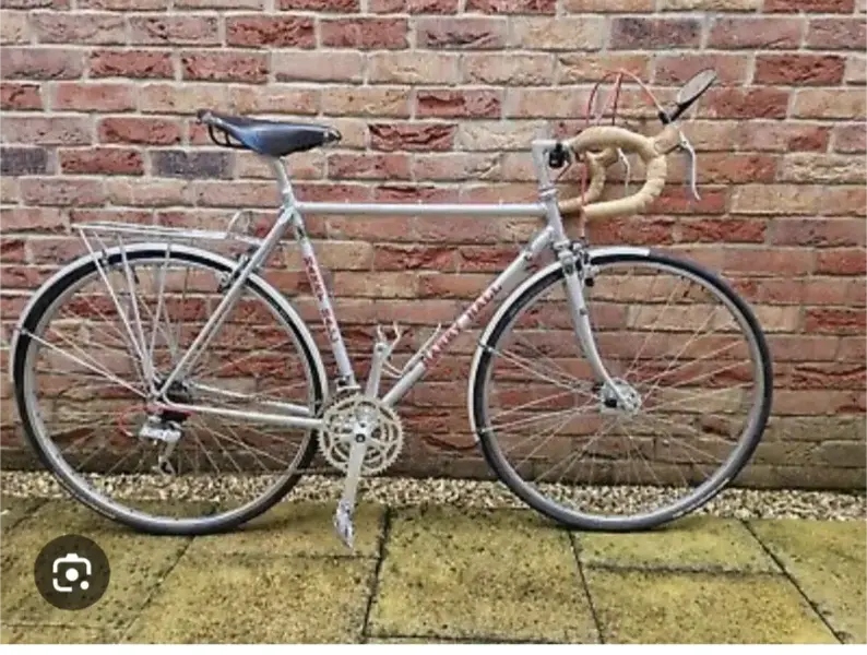

Sorry I know it's not an MTB but it's the frame advice which is really helpful. I wonder if these models (would it be early 80s) did have braze on rear stay rack mounts on. That would be a good start then I could see what the damage is if the holes have been filled. Thanks.
I managed to find a pic of a similar bike and you can see an attachment for the rear rack coming from the rear stay of the bicycle. Could this be what has disappeared to this HH and is it worth the repair ?? Thanks folks. Appreciate the advice. Feel a bit gutted. 👍
Dammit, not so good then. I'd say (presuming you keep the bike) you'll know more on how much work to fix after you file away the proud sections & filler. Could be as simple as cleaning up and painting, or having new tabs brazed in. Fingers crossed dude

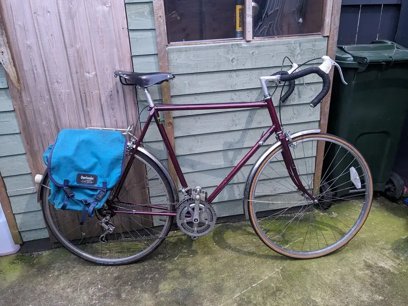

Thanks for your advice folks. I returned the bicycle. No problem at all. And ended up buying a nice Reynolds 531 with Simplex running gear. I've never used or seen much of this but it's a lovely design and is running well on first few rides. It's a (61cm frame) which I've added some bits to to get me back to a light tourer. Thanks. I'll be on the lookout for some brown/gum break lever hoods if anyone has any lying around. 1000011002.jpg
