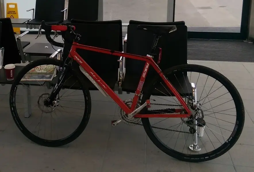

Here's mine - since stolen.
Fwiw my 5c is that they fill a niche for a fast rough path commuter. I did a strada bianca on mine, half the Ridgeway, and Reading-London via some very poorly maintained tow paths.
One caveat is I found off road downhill absolutely terrifying on drops - the that may be just the geo of my bike and the fact I was using standard (campy) ergos and standard Road drops.
I had 29er rims with 700c schwalbe G ones on it.

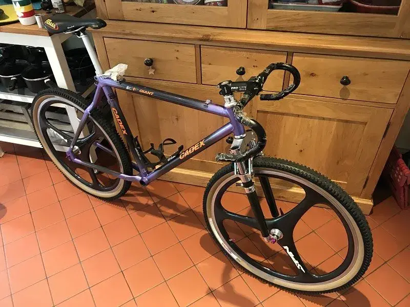

I have one in production at the moment, not for any technical reason, just that i had a spare frame and a few hours and parts spare :) I picked up a Giant Cadex CFM and the frame is a little bigger (20") than my usual size of 18". The frame is in fantastic condition and thuoght the relativley 'longer' top tube might lend itself to drop bar set up.
