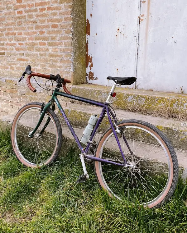

Has anyone built a Gravel bike using a retro frame
From what I've tried, it was that road shifters had less pull than mtb mechs, so the case of Deore shifters with road FD should be fine, unlike road STIs with mtb FD - it just doesn't reach the outer ring, doesn't pull the cable enough to make it.
Anyway, have tried several times, and the safe way to do this was for me to use a road 3x front derailleur (with pulley if needed, as road and top pull don't go together). However, sometimes the road shifters worked fine with mtb FD - and sometimes not. Also, asked some people with these conversions, varied from "I don"t use outer ring" and "yeah, outer ring rubs the chain" to "set it and everything works fine".

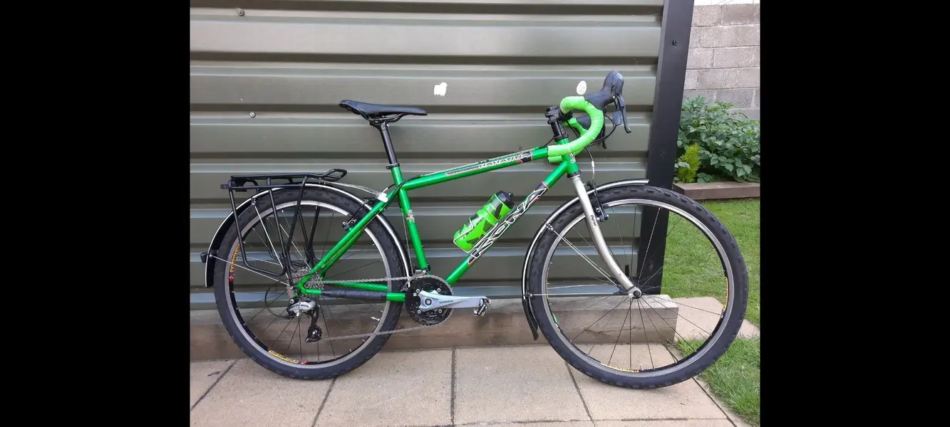

Yep, Kona Hahanna.
It was a fun experience and I learned alot.
I commuted on it for about a year but em it was very heavy with sketchey brakes! 🤣

What mods to the front mech and why? Was it a throw issue? Cage plates fouling on rings? Pics if you have them please.
Depending on pull ratio you can adjust arm length on front mech by cable route filing or in this case drilling a new cable hole. In the end I had too many gears I didn’t use so have gone to 2 by 8 the 3 Lh brifter is now set to low trim and high using the original cable routing for the lx mech
