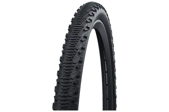

The latest development is that, despite being a CX frame, and despite what I've been led to believe in my research, it just won't take a 33 sized 700c tire comfortably.
Which is gutting, because I finally found the ideal tire for it.
So now, back to the drawing board and I need some advice...
I'm looking for a 28-32 sized 700c tire, with tan walls AND knobs! Does such a thing exist in the modern world? Does anyone have anything they recommend?
I refuse to turn it into a strictly road machine. That's not my jam. It needs to be able to handle fire roads at least, for me to get any use out of it.
So any help, advice, and pointing in the right direction for a tire that matches the requirements above would be greatly appreciated.

Again, no tan wall, but the Schwalbe cx comp 30mm is a nice and subtle tire. Not too expensive
  • Like
Reactions: Woz
^ ..... and arguably better for gravel and fire roads. Good shout @grantoury - semi-slicks are a good compromise.
