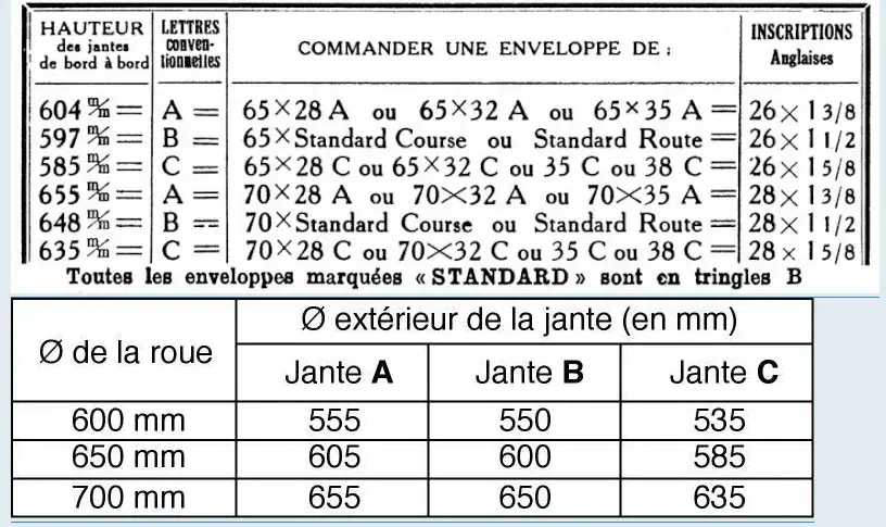

Was even thinking it may be me being a bit of a moron / too OCD / too precise, but looking at French vintage forums it drives everyone nuts. They also have to deal with inches and fractions which is not a strong point since Mr. Decimal Napoleon Bonapart changed the education curriculum.

Measuring the external rim diameter, I get 653mm which puts me between 700A and rim 700B according to the French table above.
From 1912 table, and measuring in old money I get 25 10/16". The first rim profile get's me
very close and I fall with a 28 x 1 1/2" = 700B. The second profile I fall closest to 28 x 1 3/8" which is 700A.
700A means tyres from one supplier in France or one supplier Australia. 700B means better availability.
Started to think to take a plunge with the 700B; better too tight than too floppy, lots of oil to get
it to fit?????

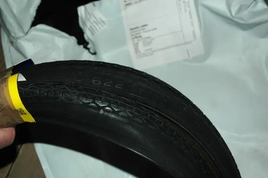

I'm going to scream, and swear a bit. I've received a normal 700C and not a 700B tyre. Back to square one. :evil: :evil: :evil:
26er, just like my tyre supplier, you are getting your tyre sizes wrong! BT homepage does not have any 35-635 tyres. :facepalm:
