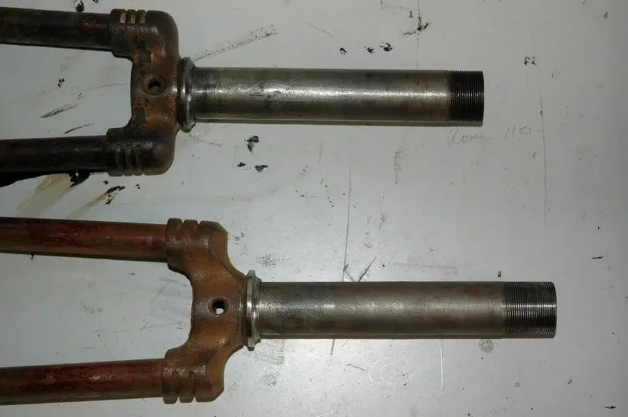

Forks off, and with some cleaning and rigourous inspection I'm opting for the forks from
Lot #1 - not the original De Dion - Bouton ones. The original forks show evidence of a
front wheel dynamo attached at some point which has sadly made a dent and rust hole.

So far I'm pretty amazed at the condition of the steel that was not at direct mercy to the elements.
The fork crowns are almost the same - if anything the one from Lot #1 appears more refined and I'm
suspecting it is slightly more recent. Interestingly, both fork columns were plugged at the bottom
with what appeared to be window putty!
There is no heart-ache about colour mis-match with this build.... :facepalm:

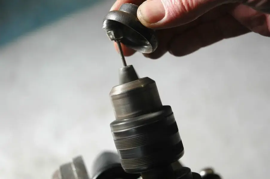

Another oddity is the lower cup of the headsets are only pushed in the head-tube bottom by hand - no press fit.
This made cleaning easy; drill in the vice with a small wire brush attachment.

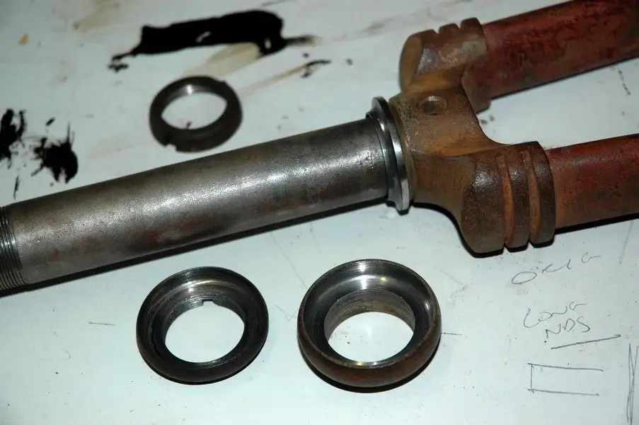

In the end I've gone for a mish-mash set-up by selecting the best condition parts.
- The lower cup and fork crown ring from Lot #1 are in absolute superb condition. They use 4mm ball bearings.
- The upper cup did not survive time / extraction, so I'm using the original De Dion - Bouton top
race that uses 3.5mm ball bearings.
I like to think that I've hacked up a FSA Pig headset with 100 year old parts. :p

A side note for the tinkerers.....the locking washer in the headset as a flat on one side, the
fork column is simply (crudely) filed down to let it slide on. Very low-tech compared to a
distinct peg and machined groove in the steerer column.
Parts all ready to fit tomorrow.

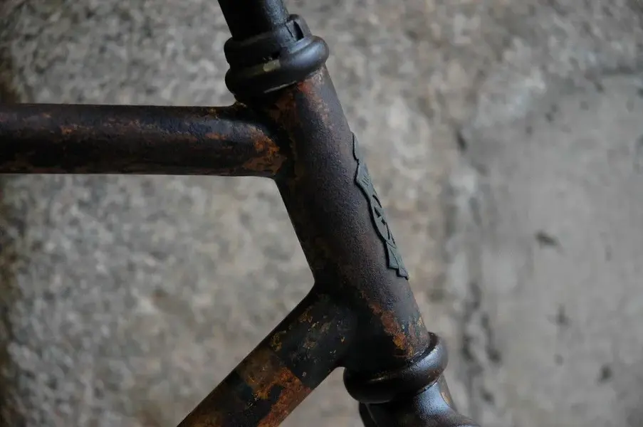

Here is a natural light shot showing the lugless front end and a beautiful textured finish :cool:
