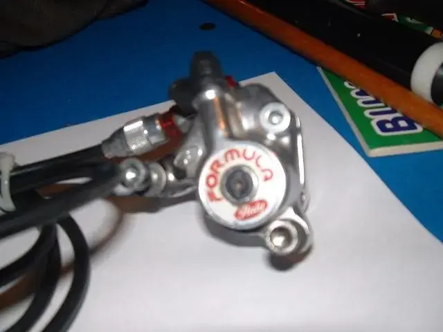

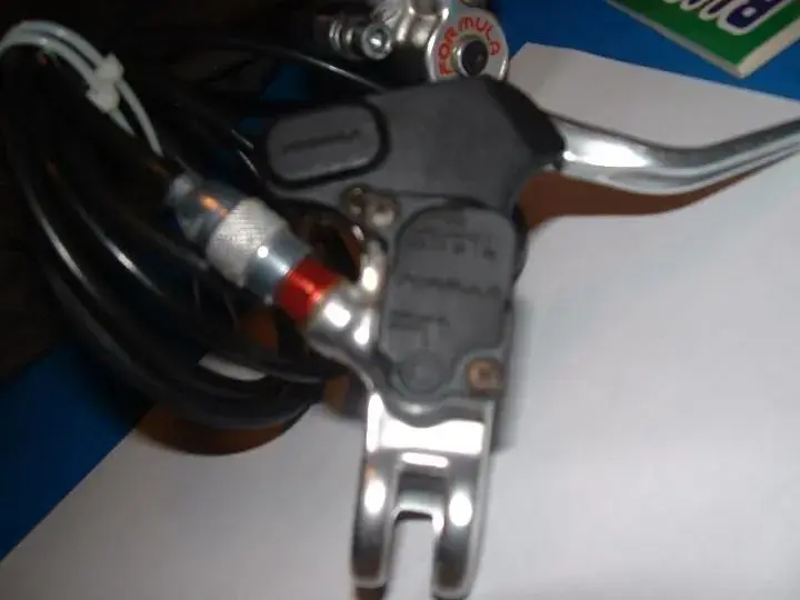

The brake finally turned up this morning. I offered the caliper up to my 98 bombers and as expected the holes are half a hole out, lovely brake though. I'm going to sound a bit dim now so bare with me, can i get an adapter to fit this to a modern fork with the 2 mounting threads into the fork leg itself? Is that post mount? There's not enough meat on the mounts on the bombers to open the holes out to suit so i'm a bit limited really. If all else fails i'll have to try and make an adaptor at work.
Anyway here's my shiney old brake.
