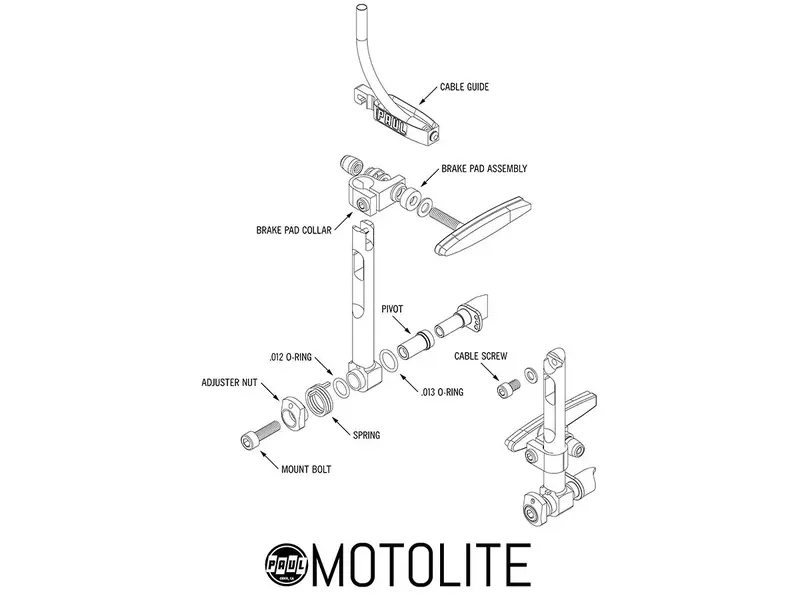

It's a bit high end, so doesn't help with the budget, but the upright arms of Paul's Motolites are totally symmetrical, so can be switched LR so that the noodle is on the right, clamp on the left:
All the best,
The Motolite is my fav at the moment. The Onzas may crack as much as their canti version. So that rules them out... Motolites or HS33
