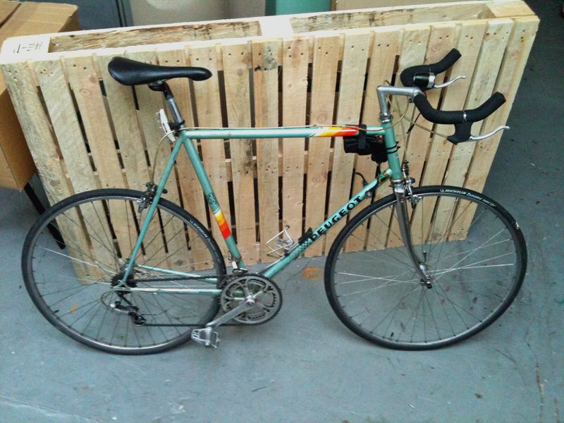

First time Roadie.....1986 Peugeot PH501
Where she stands at the moment:
Drops swapped for bullhorns (bit more of a relaxed style - she's a commuter after all)
New UN55 bottom bracket to replaced cup/cone original (just couldn't get it to feel smooth enough)
New chain to replace original (which was worn to limits)
Flite saddle
New tyres - Michelin Dynamic Sport - £17 a pair delivered. Cheap as chips so not sure how long these will last!
Wheels trued
Brakes/Gears adjusted.
Hopefully this weekend coming up I'll be able to attack with the cleaning kit and spruce her up a bit.
Really loving riding this bike.....it really is smooth and light. Amazing to think it's 2 years off being 30yrs old....

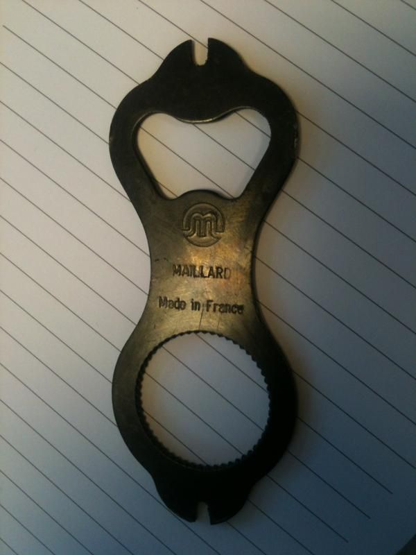

Rear hub is the only part which is a bit iffy now. I'm now on the look out for a maillard helicomatic rear hub as this one was run without a locknut on my first outing (and possibly for several rides previously). I've added a locknut and adjusted it the best I can but it's still really grumbly...... :(
I've got one i can sell, only trouble is it still has a mavic ma rim and spokes attached. Came off of a peugeot triathlon.
Cool - I'd be interested in it for sure.....I've got another lined up from a friend who has one available but it's good to have spares right?
How much would you want for it? Drop me a PM with details. :)
Another bike......another tool. The rear hub is a Maillard Helicomatic which requires a special lockring tool to get the rear cassette off.
So through the power of the retrobike forum and its lovely members I've managed to source one - cheers Paul (OldNed)!
Not only can I remove my rear cassette I can also true my spokes and open a bottle of beer to celebrate! ;)

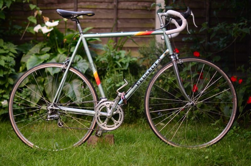

Long time no update!
Been commuting on the Pug for a couple of years now, I've since worn out the 42t chainring and the rear wheel let go (cracks around the spokes).
I signed up for a 100 mile sportive which I completed last month on the old girl, but not before overhauling the mechanicals.
Now running a Shimano 105 front and rear derailleurs, a NOS 42t chainring, a replacement Mavic/Helicomatic hubbed rear wheel, Schwalbe Lugano tanwall tyres.

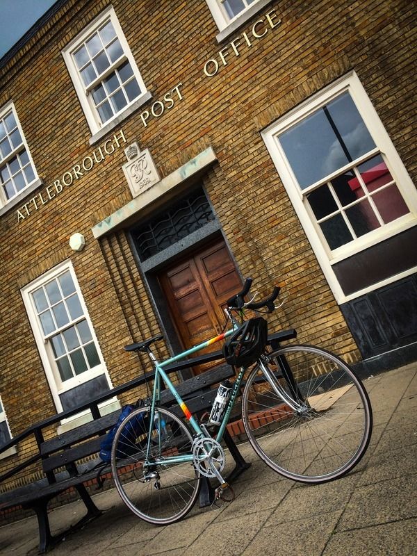

Took this on one of the feed stops that we had - this was about 66miles in at Attleborough

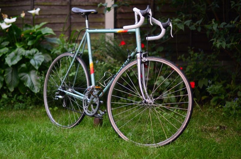

....and since the ride, after seeing photos of my riding position and becoming quite uncomfortable after riding for a long period of time I've modified the handlebar arrangement. Turns out I was riding very stretched out. To rectify I've added a shortened stem (now 60mm was 100mm) and I've re-fitted the original drop bars and have added Shimano 105 aero levers/white bar tape.
Went out for an extended commute home last night to try out the new setup - did 20miles in just over an hour and felt very comfortable.
Any comment on bar setup greatly appreciated. It feels good but I'm sure there's room for improvement.
Next mod - I've ordered a tan Turbo repro saddle which should be arriving next week.
