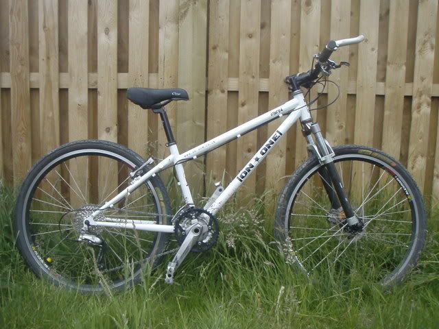

The clockwork is a 12.5 inch c2c frame with a 20 inch c2c top tube. My wife is officially 5ft 2cm and the seat post in the picture, when set up for her has the full syncros logo text showing and a tiny bit of the other part of the logo.
Stand over I measured from just in front of the nose of the saddle and it was about 26 inches.

it does, much obliged
I'm not convinced the stand over measurement is right, I measured and time passed before I responded. It could be right just seems that more than double the c2c of the seat tube?
with these small frames it could be right, the Mrs' trek is quoted as similar, and if you think 10" ground to centre bottom bracket, plus frame c-c and then allow for rising top tube, that is what gives the uncertainty as to how far along the top tube, when compare stated stand over heights compared to clearance and known inside legs.

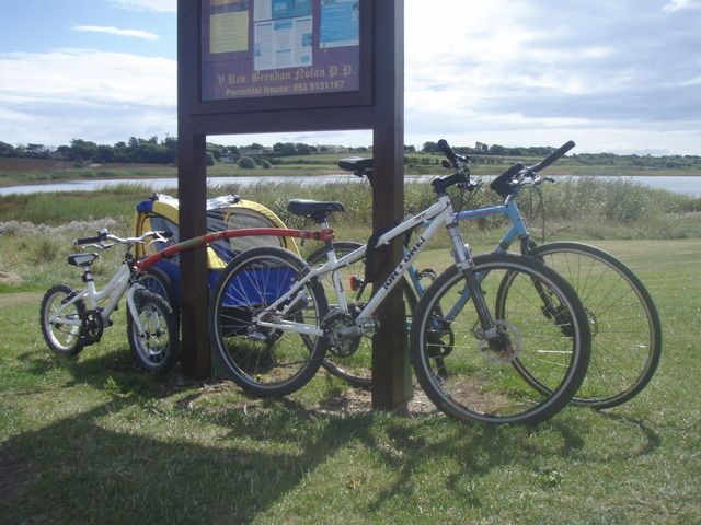

Probably not old enough (~2002) or niche enough but my 5' wife rides this (saddle a little more up when not towing the kids).
