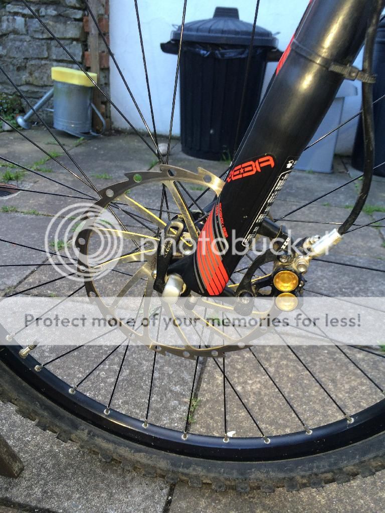

Right, long story short, a few drinks removed some inhibitions and I decided that my STS needed to at least have a go at disc brakes. It has been a few years since I have used disc brakes (Hayes stroker trails or something), and my spending has scored me some hope brakes, courtesy of barneyballbags (some wheels too :oops: ).
When I had my old brakes, I dabbled with bleeding them (seemed to do a better job than my LBS too at much lower cost), but I have long since forgotten how to do this and what kit I will need (and I will need it, as the brakes will need a bleed when I get them).
So, could someone point me in the right direction of the tools, kit and fluid I will need to sort these out, plus let me know how it is done (I'm sure there is a guide somewhere, I have not looked yet as I wanted to get the basics out of the way first).
I also want to swap out the bore caps to match the bike (blue) from gold - anyone know a good source for these, what size I need, how easy it is to do and what, if anything I will need to do once I have swapped them out?
Kind of looking forward to further modernising the STS, though it will have meant I needn't have swapped over the lowers on a brand new set of fox forks to ones that had v studs, so anything anyone can impart than can help me get these on, that would be great.
