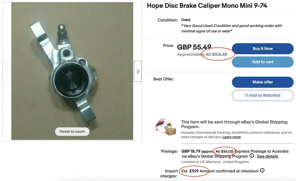

Here's the exact item on fleabay . . . very tempting except that when you add up the various costs, it comes to about AUD 160 . . . Probably not worth it.
I have a similar problem with some tech 3s. I'm sending them to hope to get sorted as while I wanted to sort it myself, once I've bought all the required bore tools and new pistons and seals I'm half way or more towards the cost of the service, which also includes new pads and a bleed. Not an option for you though being in Oz.
