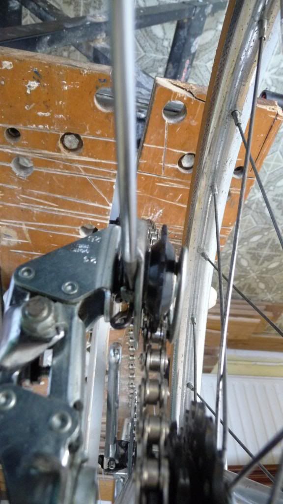

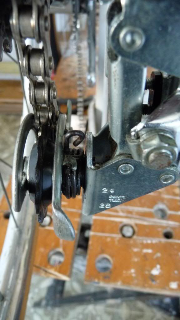

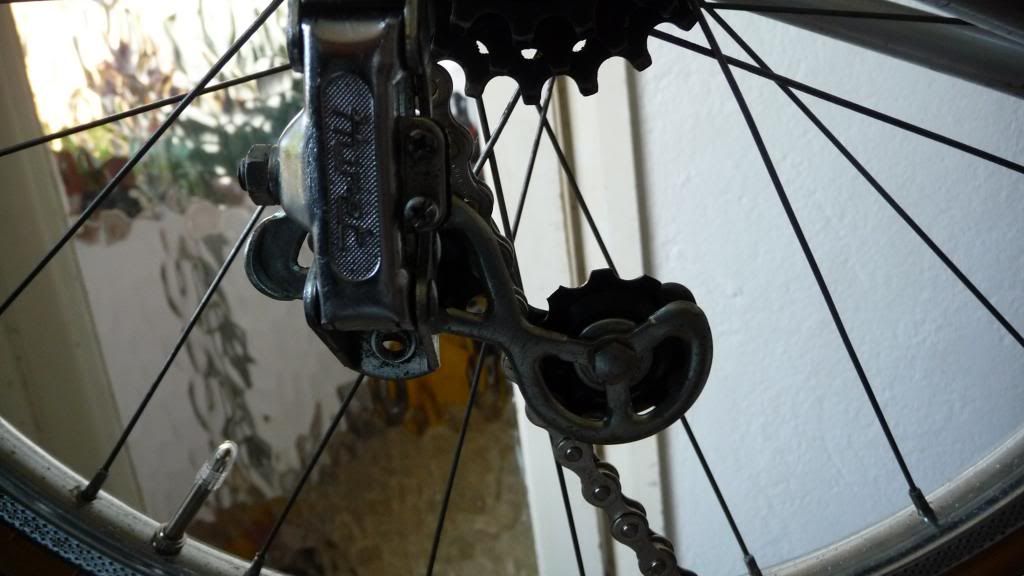

Hi guys not sure If I have the spring in the right position? Could someone check the pictures and confirm that spring should not be on the second hook? The lowest derailleur cog looks to high and that picture is in sit natural resting place?
Don't you need to unhook the cage and spin it anticlockwise to tension the spring and get it into the recess you can see in the last photo?
Shaun
Oh dear real noob I think I need to mount the cable tensioner first before anything else?
There is two recess settings without tension it sits between both recess hooks.
Shaun
Shaun thanks!
Had a cuppa thought about it twisted it 180 around and all is good! Tension is perfect now I have to stick two new pins into tiny holes I'm sure I made life more difficult for myself!
