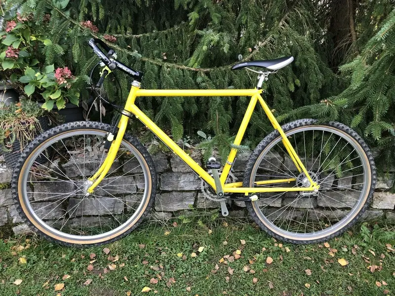

Looking to rebuild the lovely Carrera frame that @wicket off here kindly gifted me. It has a u-brake. I hear these are a bit rubbish. Would the stanchions take a v-brake replacement?

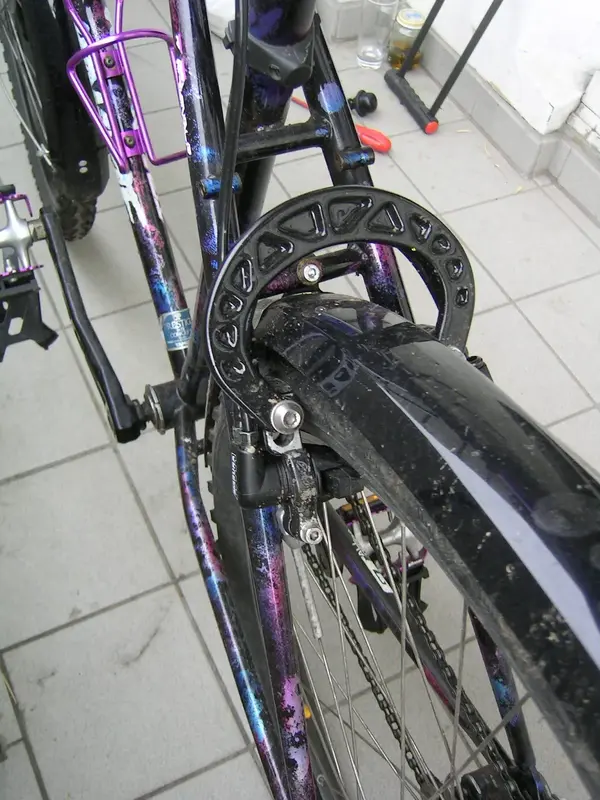

U-brakes were pretty good, and well adjusted certainly comparable to a cantilever. However, they do need watching as the pad wears (as they can end up eating tyres).
Not aware of any adapter available.
there are some odd adaptors out there but your v-brake would be right down in the dirt!
and the posts/ bosses are way too high, basically in the wrong place anyway
Sure I have seen an adapter, though not sure if it was homemade.
But like above, U brakes are very good, easily as strong as V brakes
There is a thread on the other way, no doubt the Odyssey U4
brake booster/adaptor can be used the other way around if you buy the boss bits etc.
