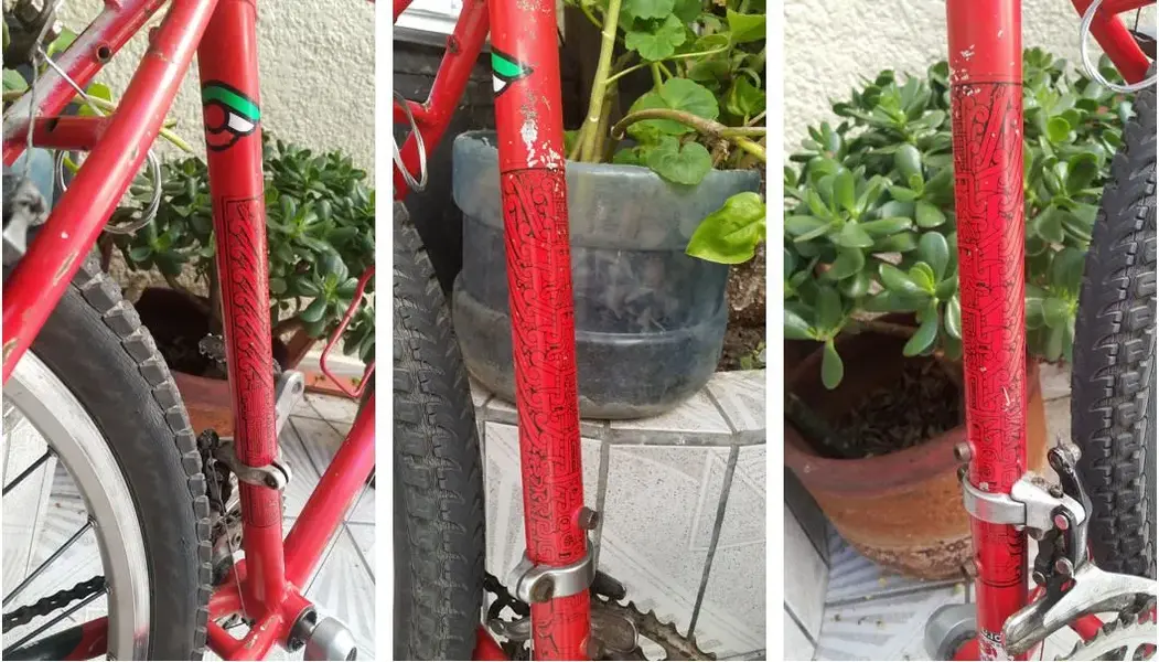

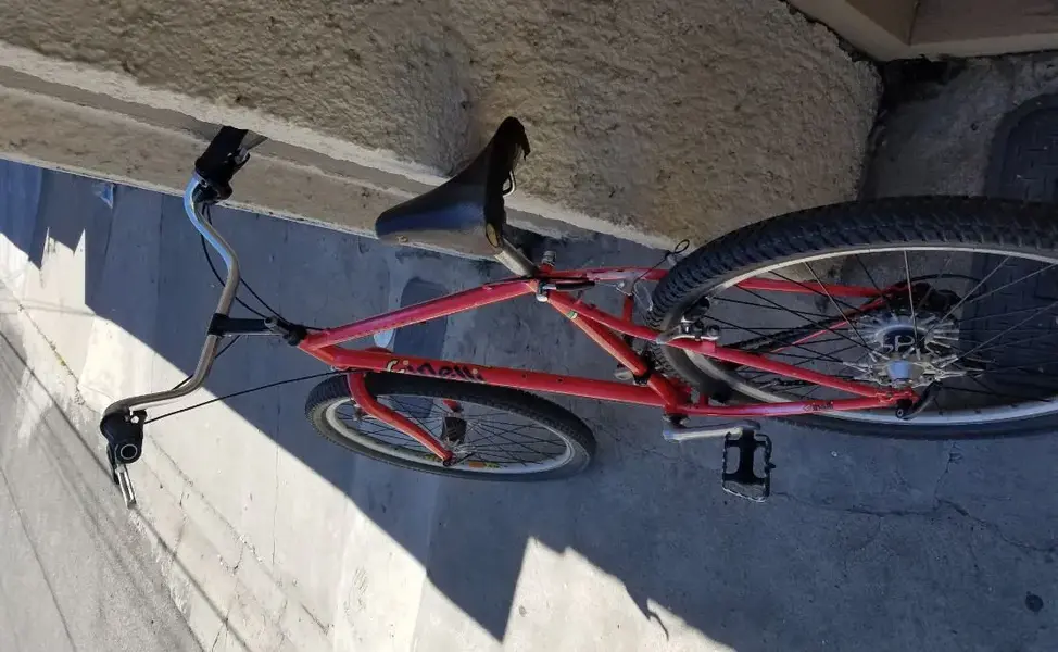

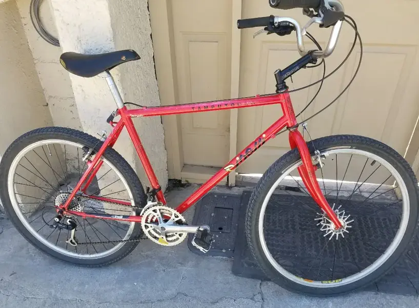

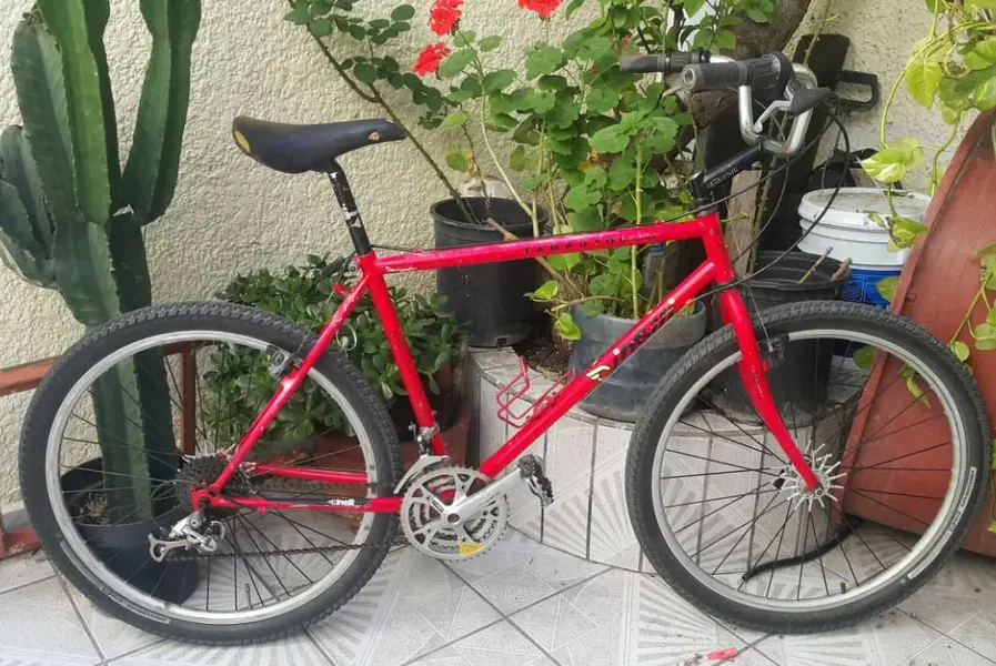

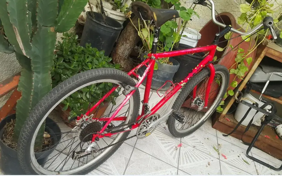

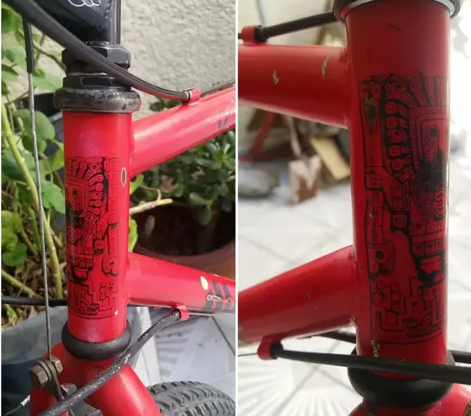

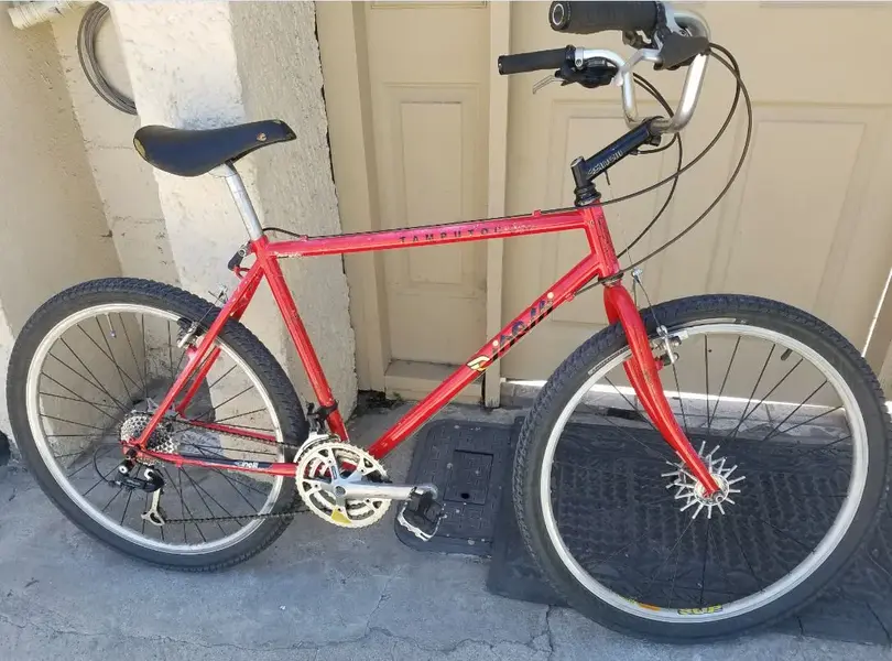

does any one know what is the seat post diameter for this
I've tried 25.4 mm and is too loose
26.8 mm to tight
I dont recall ever seeing 26 or 26.4 mm diameter seat post which I think should fit
but if someone has I appreciate it if you can point me to it
I know it may be a dumb question, I have measured with a vernier one diameter is 26.8 and moving goes to 26.3
i dont think the seat tube is oval shape rather is hit but dont want to crack the paint more.
any suggestion is welcomed
