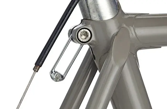

Something like this then?
If plastic is strong enough can it bec3d printed? I'd need measurements but I'd be happy to give it a try.
That post bolt location is problematic. Was going to suggest one of these options, but the orientation is wrong View attachment 739734View attachment 739733
That’s a good idea actually… I could potentially mount that type of hanger on the Allen bolt of the plastic dog collar (imagine the dog collar is the seat clamp in the photo above).
Then I could make a ‘noodle’ around the seatpost with a piece of outer cable - with the other end of the outer cable either clamped or zip tied to the top tube…
Would be a bit Heath Robinson but could work.
