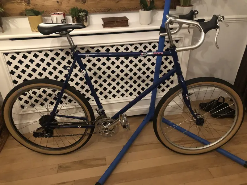

Hi, I’m building up the above model Ridgeback. Would anyone know the seatpost diameter? It’s Tange Prestige tubing. Have tried Googling but no luck.
It came with a 26.0mm post that slides down the seat tube once the quick release is undone, suggesting it’s undersized I think.
I found a frame database on here, no Ridgebacks specifically, but most of the Tange Prestige frames used 27.0mm posts. Does that sound about right.
Cheers in advance for any help,
Luke

Is it the fillet brazed 605? - that has to be one of my favorites from the Freewheel Catalogue of the same year. Any pics/ build thread?

Yes, I think it’s the fillet brazed one.

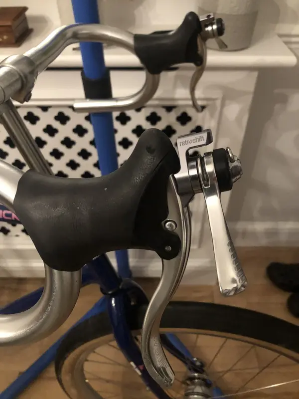

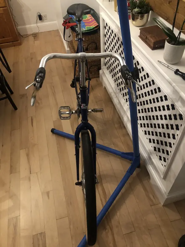

I’ll try and attach a couple of pics. It’s a work in progress, needs cables and the lights and Dynamo wiring doing.
(Apologies to the purists but I’m butchering it into a gravel bike.)
