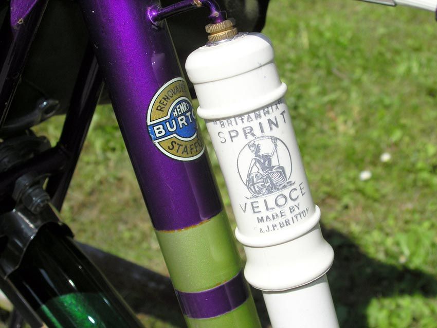

Beautiful colour and lustre - I wonder what paint is used here and what Pantone or other colour they used on my one (your paint is nicer than the one on mine by the way) It'd be nice to know which colour as then I could retouch some of the paint round the seat tube cluster and stays .
and that pump is lovely, Universal have one :
not sure if this is a frame pump or whether it'd fit.
