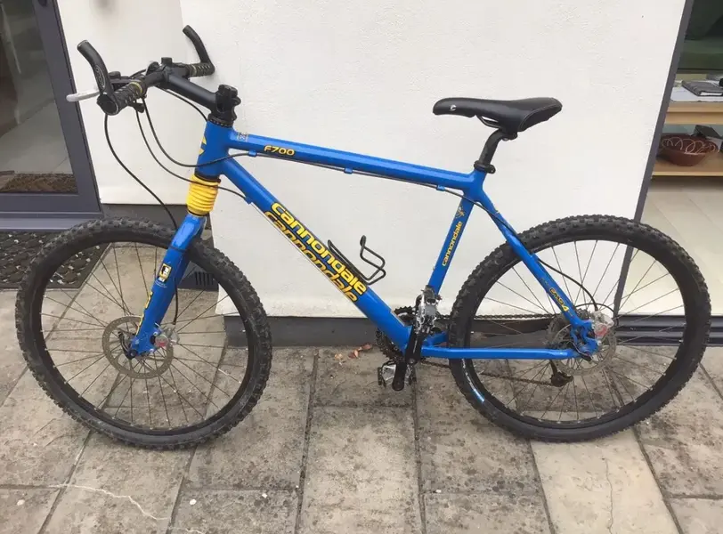

A bit of eBaying and I found a seemingly good example in XL that looked fairly original from the photos:
The main issue was it was in London, I live in Nottingham and posting wasn’t an option.
So after work one night I decided a road trip was in order. I knew immediately that stem was going to feel awful for the more upright riding position I’ve become used to. The stars kind of aligned, I managed to find a 90mm more modern version in the relatively rare 1.56 inch steerer tube. And to top it off, it was also in London, 15 minutes from where I would collect the bike. The stem is a bit high on rise but needs must until something lower becomes available.
Upon collecting the bike, it was immediately obvious it was completely original. Even down to the Hutchison mosquito tyres. I was blown away by how good condition it was in. Even the Julie brakes were sharp, surprisingly so!

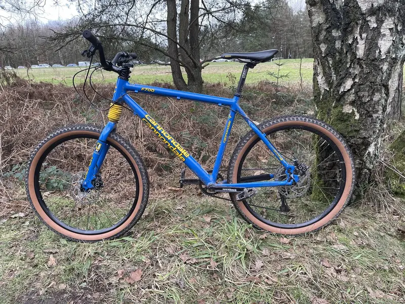

It’s almost in its final form. As mentioned, I’d love a lower stem, possibly shorter. Bits I’ve changed:
Wheels: WTB i23 rims, which I built onto hope pro 2 hubs. Relatively light weight and super reliable.
Tyres: originally I had billy bonkers, but they were awful on mud. These are made by baldys. A budget brand but my goodness are they an improvement. Really impressed with them. And they have a little bit of a retro look.
Brakes: keeping the magura theme going, I used a set MT Trails, running them the opposite way around though, 2 pot on front and 4 pot at the rear (once a trials biker… always a trials biker).
Running gear: Shimano deore 10 speed shifter, clutch mech and cassette: 42-11t. Chain is a KMC, which I absolutely swear by having tried many chains over the years and put them through hell.
Cranks: RaceFace turbine LP cranks, with a blackspire snaggle tooth 36t NW ring. I did run some polished middleburns with a beautiful Medium chainring, but they are far too ‘blingy’ for this build and looked so out of place. I have another use for them 😉
Pedals: some cheap but cheerful plastic ones from Ali express. They are temporary whilst I rebuild some DMR vaults (Brendog signatures)
Bars: my least favourite bit, nuke proof bars with a horrible profile, they feel okay, but I’d like some thing with a bit more rise (2.5inch), preferably a glossy black finish for when I replace the stem…again.
Seat: coda 700 (selle italia) to replace the cannondale saddle that came on it. The yellow logos were much needed.
Having been out on a few local rides, I’ve fallen in love with it. The long top tube and shorter stem makes for a modern feeling bike with your weight planted quite centrally.
I’ve been riding it on routes that I would have previously ridden a 2015 cannondale trigger full susser. It’s nailed them, and made it much more fun in the process. I also left my mates behind on this… which I haven’t done for a while. The perfect bike for such rides.
The headshok has really taken me by surprise, this one has 80mm travel, works well and exceptional over small bumps due to the no stiction design with needle bearings. I’m sure my view will change when it comes to servicing it though 😬

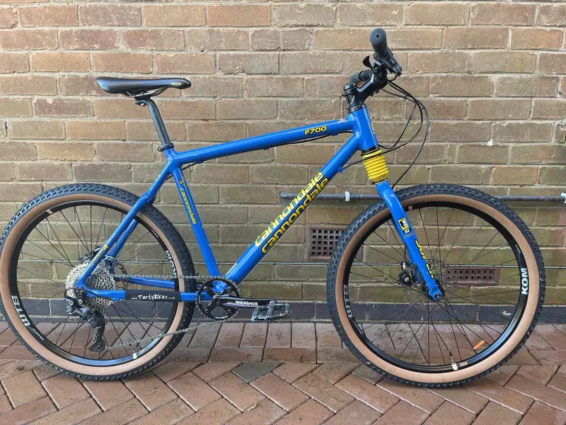

Another picture, a few bits changed:
Lower rise 90mm hope stem, soon to be replaced with a reverse components.
BLB riser bars
Hope tech enduro rims on pro 4 hubs.
Seatpost, again temporary, I’d like a straight post, but this one will do for now. I’ll we how I get on with the 60mm reverse stem first.

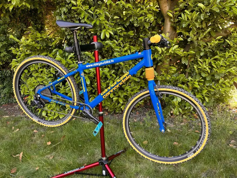

brilliant build mate, I did a similar 1x conversion to an F900 summertime last year, will attach a pic at some point

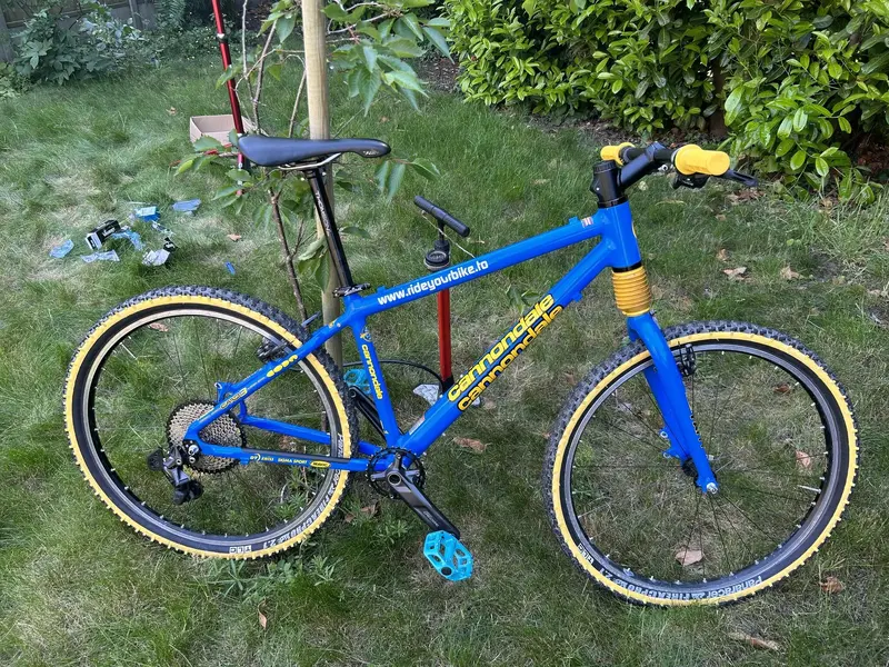

Here bud:
Not the greatest pics but it was decent.

Very nice indeed! Would love a straight Thomson seatpost for mine. The yellow fire xc’s look great. Very reminiscent of Ashtons with his front yellow Hutchinson. I have toyed with the idea of doing a full blown trials build on a smaller frame. That would have been ideal!
