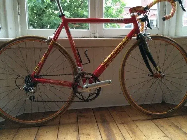

Here is mine, with Campa record, cinelly, tune.
The Coda Magic 900's are the best cranks to have from that era, much lighter and stiffer than the Campagnolo record for instance. Just be careful with the special double threaded crank-bolts, I have seen broken ones and very difficult to find them.
more info on the cranks:
http://www.bikeforums.net/classic-vinta ... nkset.html
http://www.retrobike.co.uk/forum/viewtopic.php?t=215374

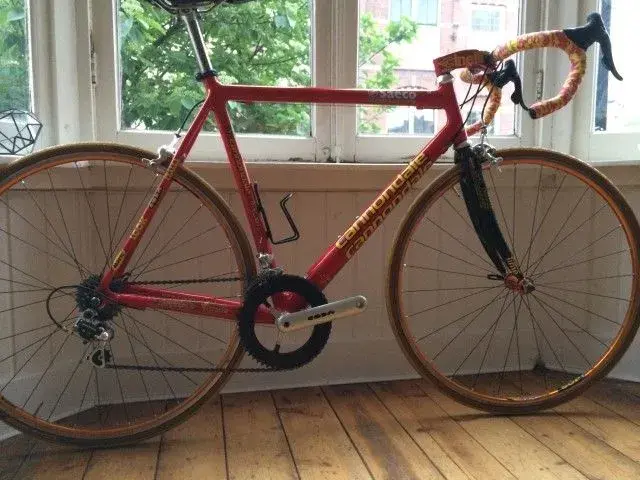

I've had this bike for about eight years and done lots of miles on it. Less so lately due to riding my steels.
Original DA7700 group, Easton circuit wheels with gatorskins, Specialized adjustable angle stem, Selle SLR saddle, carbon post. Weighs in at 8.6 kg complete. 1999 frame build.

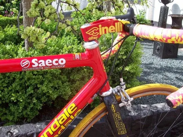

at first i bought chouca's frame as a replacement for mine. the bb_shell had the threads coming out and i was told it couldn't be helped. but fortunately enough for me the threads were pressed into the bb-shell and i was able to glue the whole thing back in.
so far it has held up pretty nicely.
i've never seen this on a cannondale before. maybe the previous owner stripped the threads and had new ones pressed in for repair?
anyway, i now have a second cad3 saeco frame which i'm probably gonna build up with da7700 this time.
i do have a time club straight leg carbon fork for this one here already.
just have to decide wether to thread it or keep it threadless with ahead stem. :roll:
Autch - never sell a BB shell like that. Normally if the threads are gone I'd use a Mavic sealed cartridge BB. But that wouldn't help in this case.
Re: putting threading on an Ahead fork. I'd avoid that too. Why don't you use an Ahead stem?
