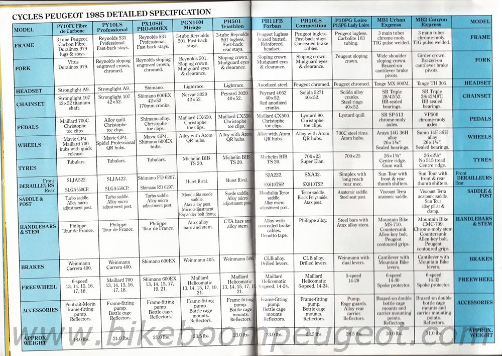

Amazing what a spot of bored Googling can turn up, I appear to have solved my own mystery! Unless I am mistaken, the bike appears to be a 1985 Peugeot P10PG Loire tourer, finished in 'Misty Blue'. Does anyone on here have any experience of these bikes?
Good bit of googling:). The product ID code is on the chainstay as you can see but aside from the px models they usually had another name :)
