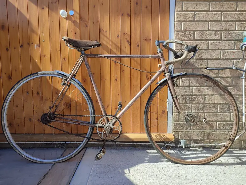

The bike is complete and all original as far as I can tell - well-used, but mechanically fairly sound. The frame was probably the worst bit.

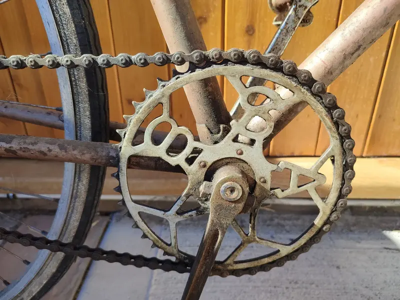

The front wing nuts may be original, so is the front hub. The original rims were Dunlop alloy 27 x 1 1/4, In 15 years as a retailer (50s /60s) I never saw even one. You seem to have the correct alloy 46t chainring and 6 1/2 inch forged cranks,. The original pedals were solid centre with alloy quill side plates. You also have most of the original brazed on brakes.
The original saddle was B37, like B17 but alloy frame.
The BSA hubs, handlebar stem, brakes, pedals, wingnuts and chainset were only used on the gold column.
Keith

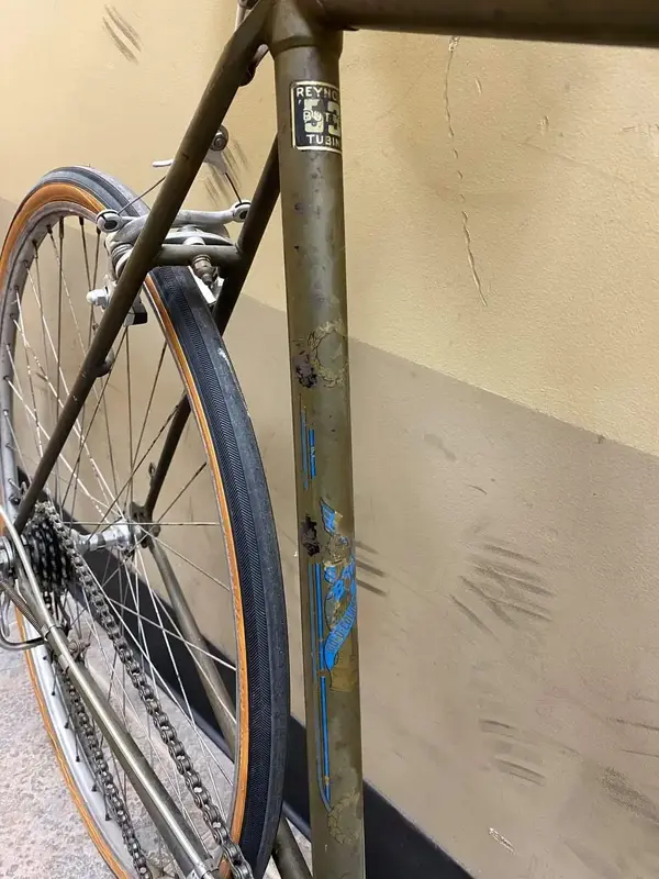

Tried H Lloyd, but no joy. They said they'd be happy to print if I can provide sufficiently detailed images. The one I'm struggling with is the column image on the seat post. I've attached the most detailed image I've found so far. 132003923_10222176287590229_3161623045717715379_n.jpg

I see you have the 4 star gear, really awful thing but very rare, correct freewheel hub, and looks like a dunlop rim. not surprised someone changed the back brake, they were very light but nearly useless. The chain was renold elite 1/2 x 1/8 with shouldered rivets, you have to pull a side plate off not push it through..
Frames were well made, but why use a cheap fork crown and D to round blades?
Keith
That last pic isn't mine - just the best image I've found so far of the seat post decal. Mine seems to have been green rather than blue.
