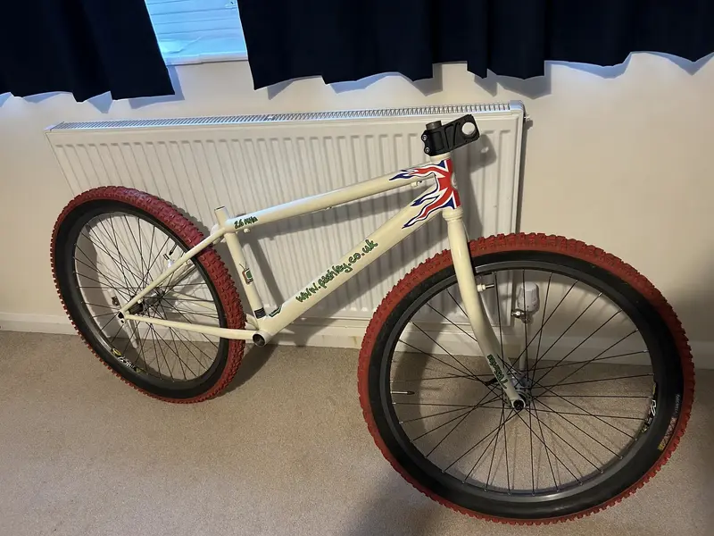

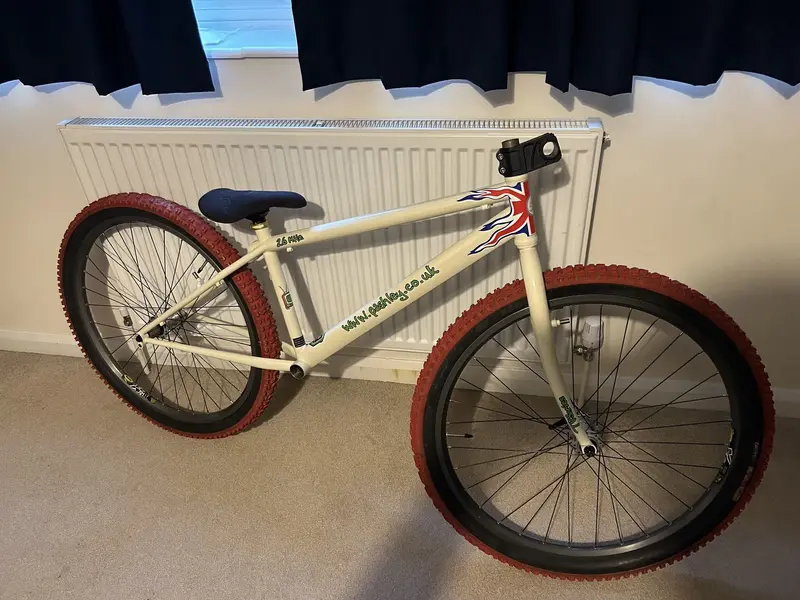

Mock up!!

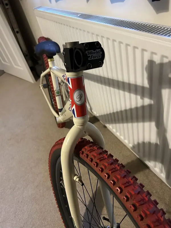

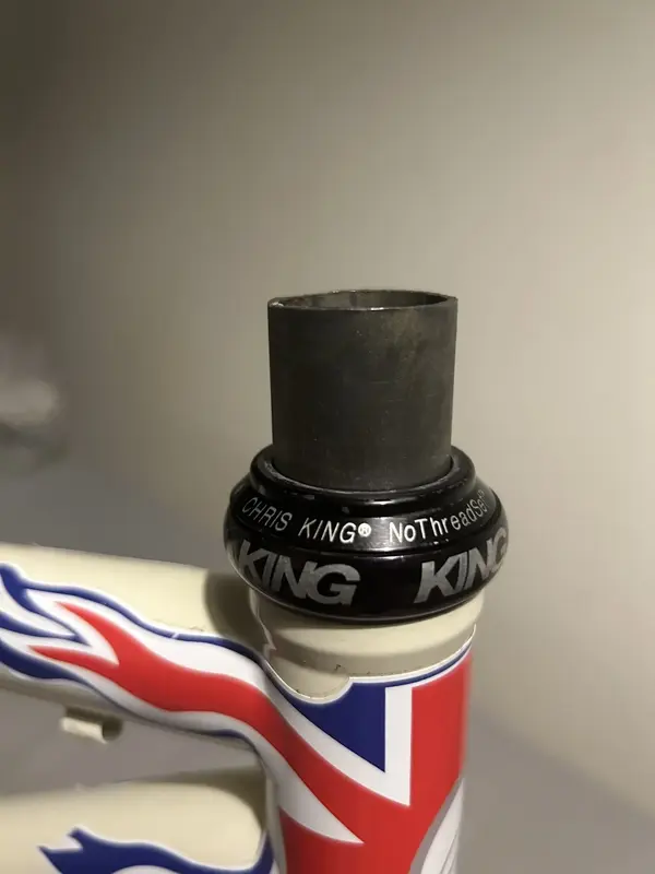

Right so I fitted a black CK headset to see if the steerer was long enough and guess what…it wasn’t!? Luckily my mate Alex is going to extend it for me by TIG welding it👍

Yep the original owner has the same issue and the King is a high stack compared to others. If you do end up extending it, make sure it's sleeved internally and then welded as well. Also go for a bit longer and add spacers

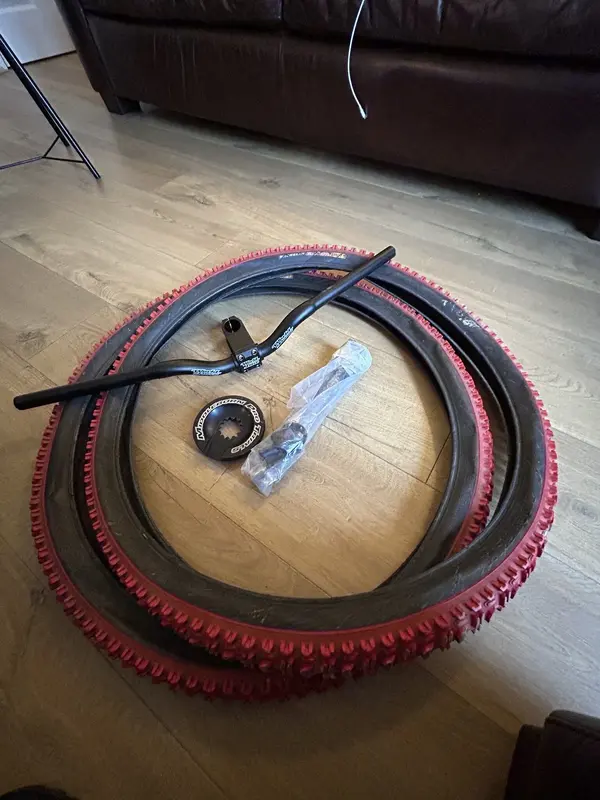

Did another mockup last week just need to post pics to the thread tonight. Fitted some Raceface bars and Red HOPE skewers so it looks even more like a bike now, oh, and i got another delivery from @PLIW , mint set of Odyssey Triple Traps! Still need to send fork off to get steerer lengthened.
