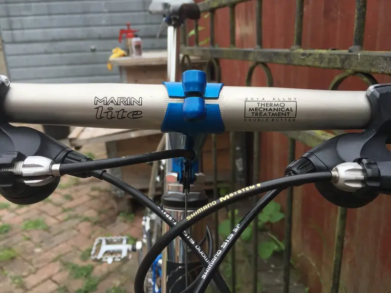

Managed to find 2mm SLR brake cables,the old 2mm ones,in the past.Was a seller on ebay with a crate load of front ones for sale,had enough cable/outer to be used for the rear too.Slightly later Shimano 'M-system' ones are around,the modern versions are pretty similar to original and still being produced.

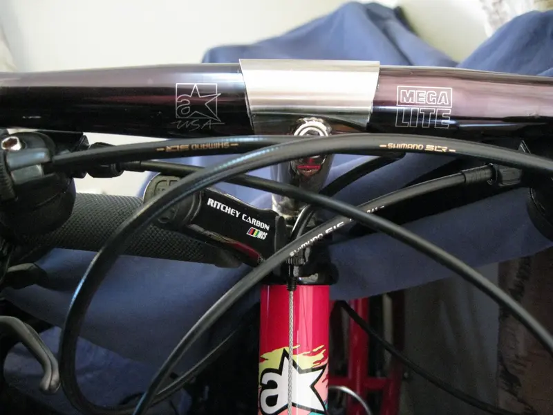

I use modern Shimano SP41 gear cables,don't think they look out of place.
So far,with brake blocks,I've been fortunate and always managed original ones.Have barely used original ones on my '92 Cro-Mega,one small crack in the rubber on one block,otherwise great.Couple of bikes with NOS M737 cartridge pads.Can be a bit hard as mentioned but can't say it's noticeable with braking.
It's pretty much all Shimano with me but there's certainly some good aftermarket,Clarkes,Fibrax etc.Was warned away from Jagwire by my mate,LBS mechanic,reckons the inners are a bit prone to breaking compared with Shimano.Had a couple of cable outers break with Jagwire.Good selection of colours/finishes,though not very retro.
