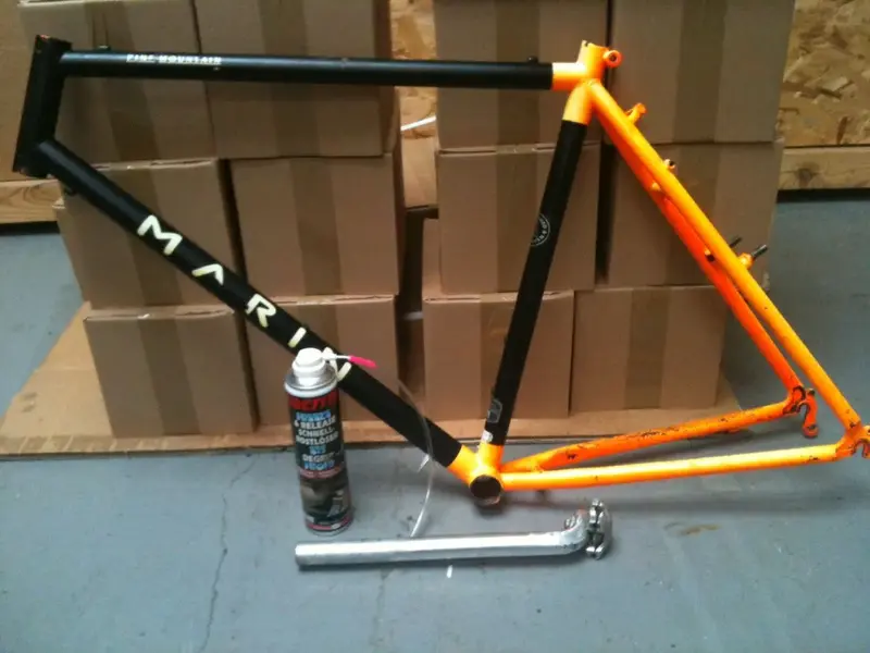

As Recieved, from David all packed and squared away with the greatest of care, total gentleman of the forum. My plans are a little different with this one, to yours Boy'o'boy. After removing the seatpost (it's having a looong soak!) I'm going to treat the rust and touch up the primed areas as best as I can, repaint the forks and rebuild the frameset with original decals intact. I like that it's had a life and shows it! The BB is out now and is very serviceable. I'll put some bits on I have squirrelled away from here, inc some Ti Sakae Bulges and a TCO post I have, use the XT 730/732 wheelset that David sent with, same on group.

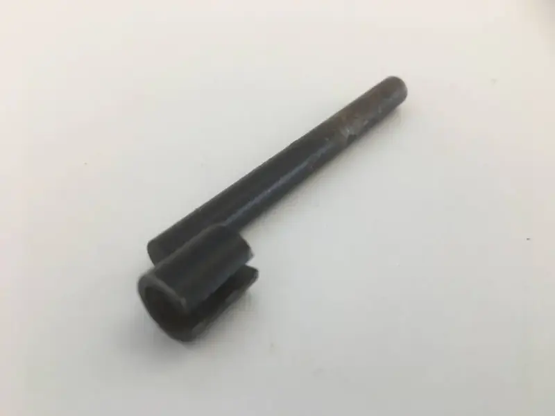

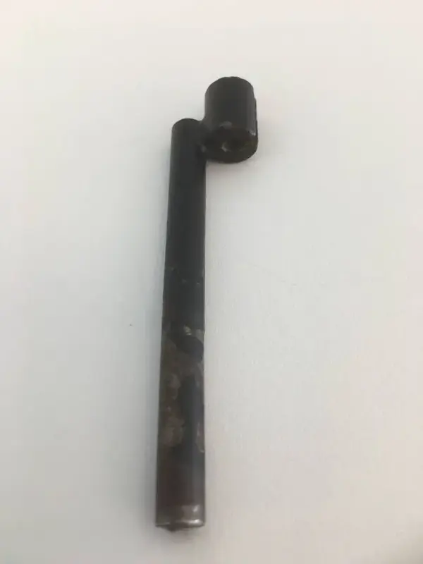

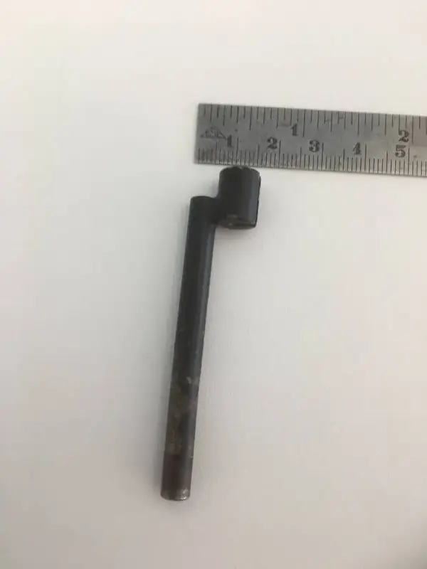

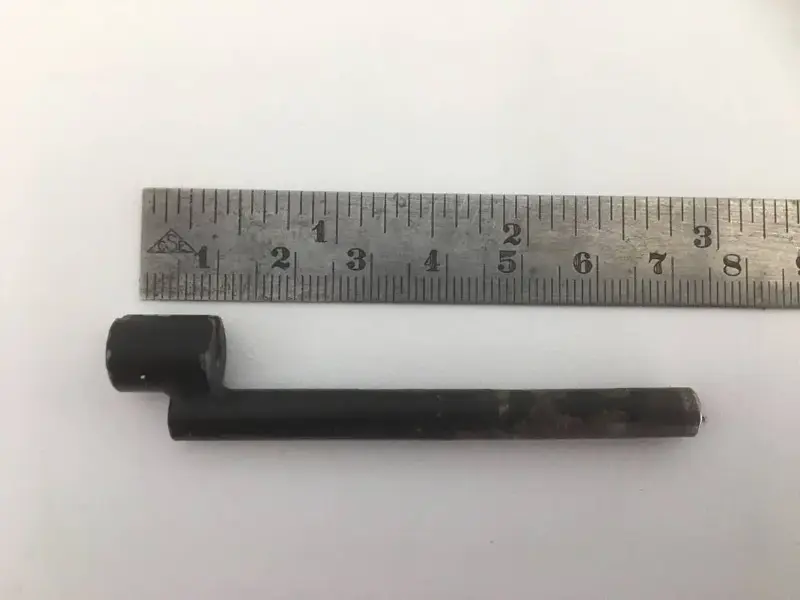

I've also taken some pics of the 'fork noodle' that's missing from yours. It looks fairly straight forward to fabricate - a cable stop TIG'd to a 5mm Steel Rod.
Here you go...

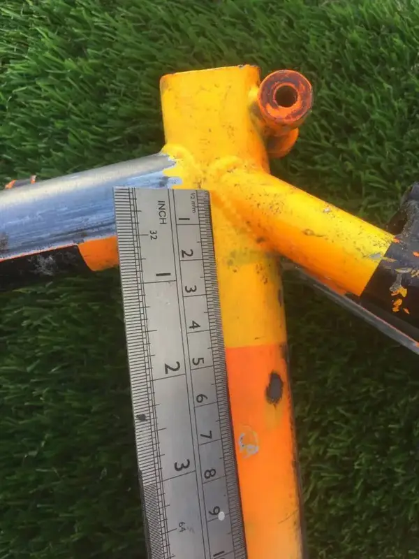

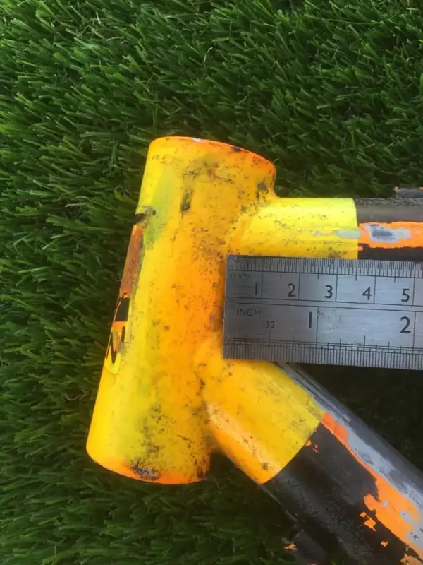

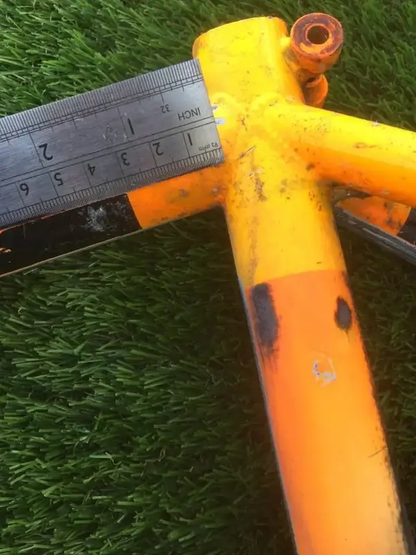

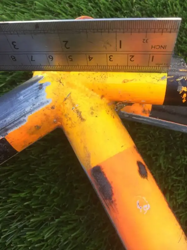

So, I've started to strip the paint from the frame..... it's a better painted than the forks (they used primer!!) so will take a few evenings to get all of it off before the primer base coat.
Sensibly ;) - just before I went straight in with the 120 Grit! - I measured the points I needed to mask up when I apply the matt black over the neon orange.

...more dimensions of colour break up bands.
Here you go...
Cheers boy"o"boy, that's solid gold right there. Also Matt and others for your words. David kindly supplied the missing piece of the canti stop, it caught the worst of the rust. Can I ask, where the 5mm steel rod sleeves into the fork, is it welded in on yours, or threaded or just pressed in there would you say?
I recently picked up some hydrostops from another forum member and was going to use those short term, use the 5mm steel rod into fork sleeve as some kind of hose clip, but that's still tbc!
I've thrown a couple of hours at the seatpost, still no movement, it's had its seat tube filled upsidedown with plus gas, up until it's peeing out of the bb hole, soaking for a couple of days. The pipe freeze has just arrived today. The post is all the way in so can't get a good vernier on what's sticking up, to provide an insight into the size. Also on this bike, the rear triangle was accent colour, or at least is accent colour, underneath the black, which is a match for the mainframe and I would be sure is original.
Strangely that is a part missing from mine to but no sign of it ever being there.... I spoke with a local frame guy who was a little concerned about putting any sort of heat near the pressurized end of the fork, I think he was worried about a potential gas explosion that could take out his face :LOL:

Good option with the Maguras if you didn't want to replicate the missing part. It just slots in btw...not welded or bonded.

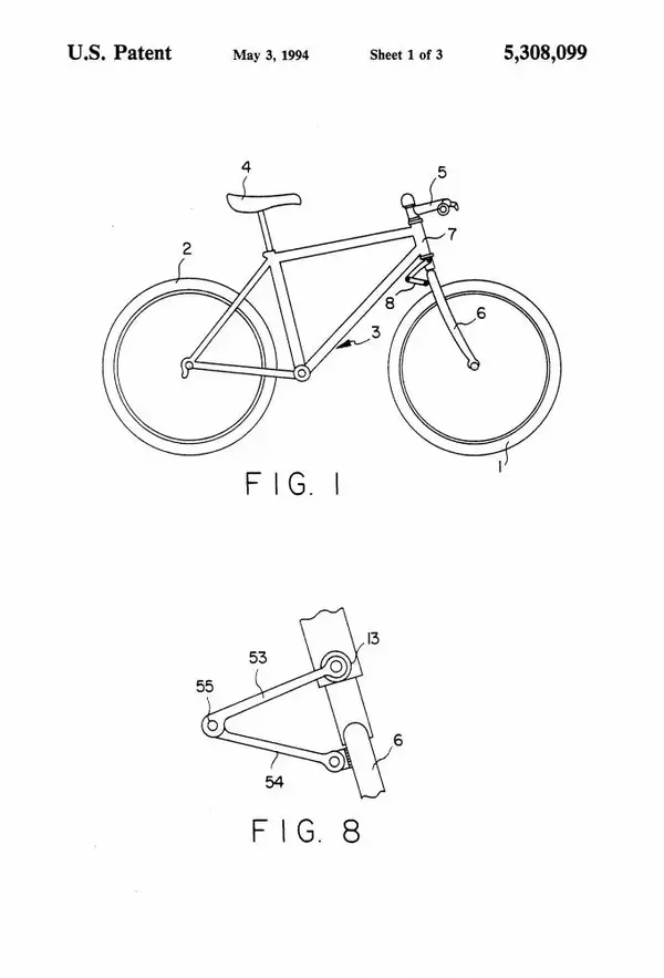

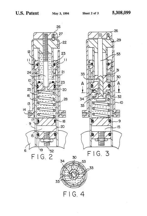

https://patents.google.com/patent/US5308099A/en
Interested to see what was inside.... I went and had a look at the Patents for the Browning suspension fork. Still not taking it apart though!
