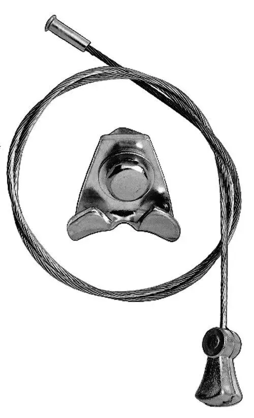

I was a big fan of canti brakes up untill around 1989, when the front main brake cable on my Muddy Fox Explorer
snapped on a road descent, the straddle cable dropped into the tyre knobblys causing the front wheel
to lock up, bending the rigid front forks almost back into the downtube, oh how I flew.
Not long later discovered some little plastic device in the bike shop called a rhino horn, this
bolted through the fork crown hole to act as a catch hook, bit bloody late, by this time I had reversed
my forks and used a couple of bits of angle as splints on each fork blade, held together with some sort of gaffa
tape, obviously no front brake at this point and I couldnt afford a new fork, over time a flex developed which
made for a suspension feel.
Avoid these types of cantilever straddle cable.

If you use fork mounted hangers; another way of keeping the straddle cable off the tyre is looping a cable tie(zip tie) around the hanger and the straddle cable. Set it so the straddle can't fall on to the tyre without the main cable.
It goes without saying that brake inner cables, and straddles for cantis, is something not to skimp on. Always buy a named brand, from a real bikeshop, and in stainless. Avoid joerandom1234 on ebay and his super cheap, non-stainless, and no-name inners as they could actually be made of cheese.
