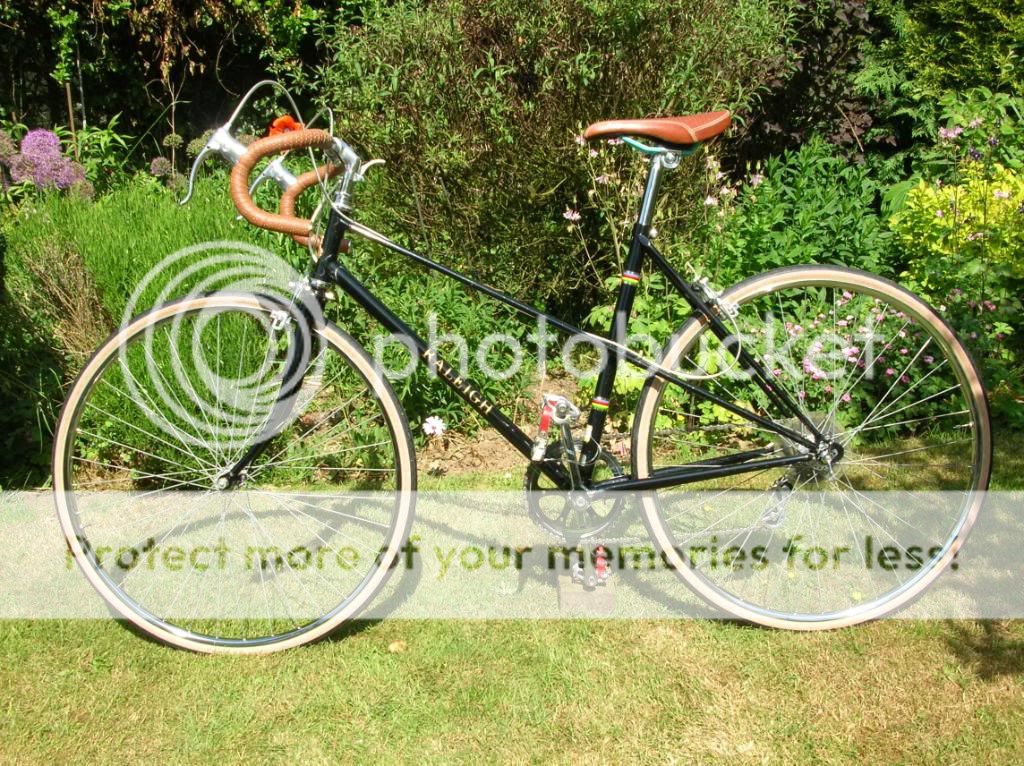

Any advice for a newbie rebuilding a Mixte?
One thing you might find with tyres: 35mm may or may not fit without fouling mudguards and/or frame. Worth considering.
32mm is probably going to be alright, and will make everything far comfier.
And the Union pedals fitted to it currently are a really good choice; very hard wearing and because they're big offer lots of support for people that won't wear special shoes for cycling.
Ive got a mixte here, And ive had a few others... Whats the real reason for a mixte frame? Are they womens bikes or more of a unisex thing?
The one here now is a Raleigh , Mid 80's... Gonna get it up together and maybe sell it soon....

Here is one I did for my son's girlfriend.
