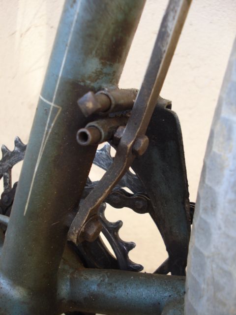

The big issue with this restoration is the front derailleur.
The brazed support seems really original.

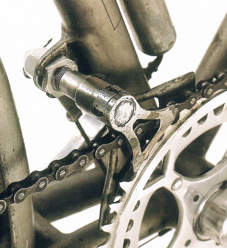

Unfortunately, it does not look at all similar to other Narcisse around the war "designs"
And not one for existing derailleurs like the Simplex 38

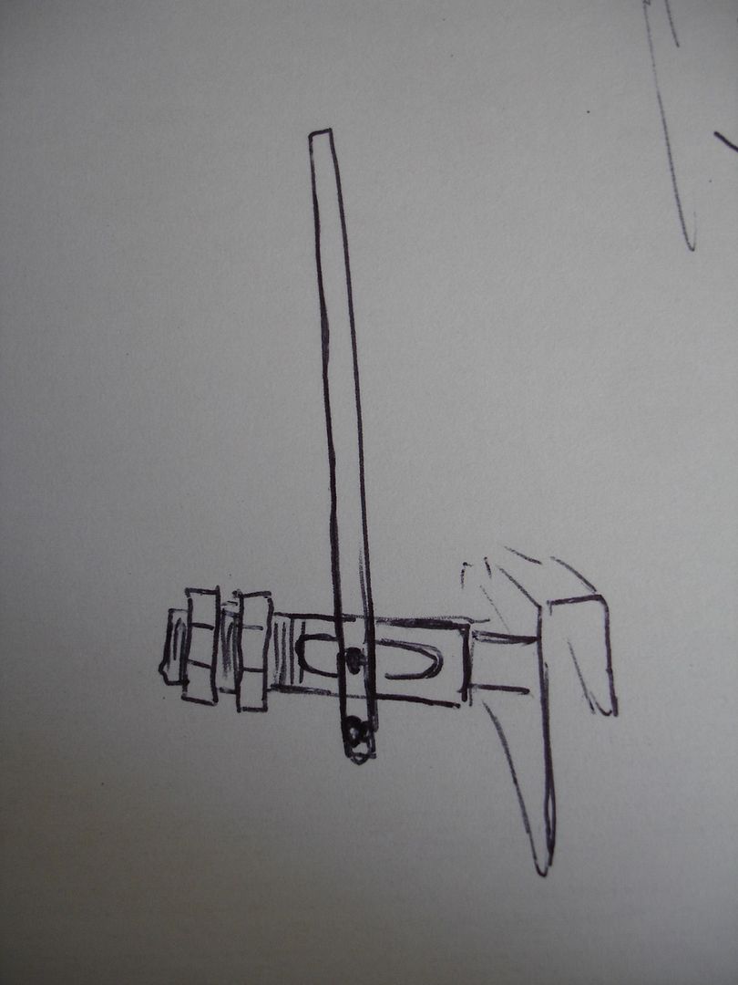

a first imagined design was this one
[/quote]

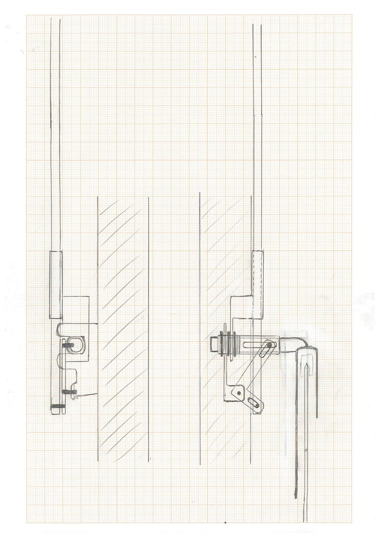

with refinements like this with a lever with a down and up movement for easier use
But this sort of design is very seldom seen ( Ducheron did something in that line but after the war) and quite complicated to realize so its probably going to be a mix of these - le chat lever - on the right of the first pic / cage after Narcisse design to take a 46 chainring as its most probable that it cannot take more due to its position on the seattube / and lever articulated on "bottom pivot" with an adition to displace the pivot position as it is very close to the cage horizontal support so would displace the top of the lever laterally lever too much to the right or left of the seattube if it were to trigger enough movement of the cage.
