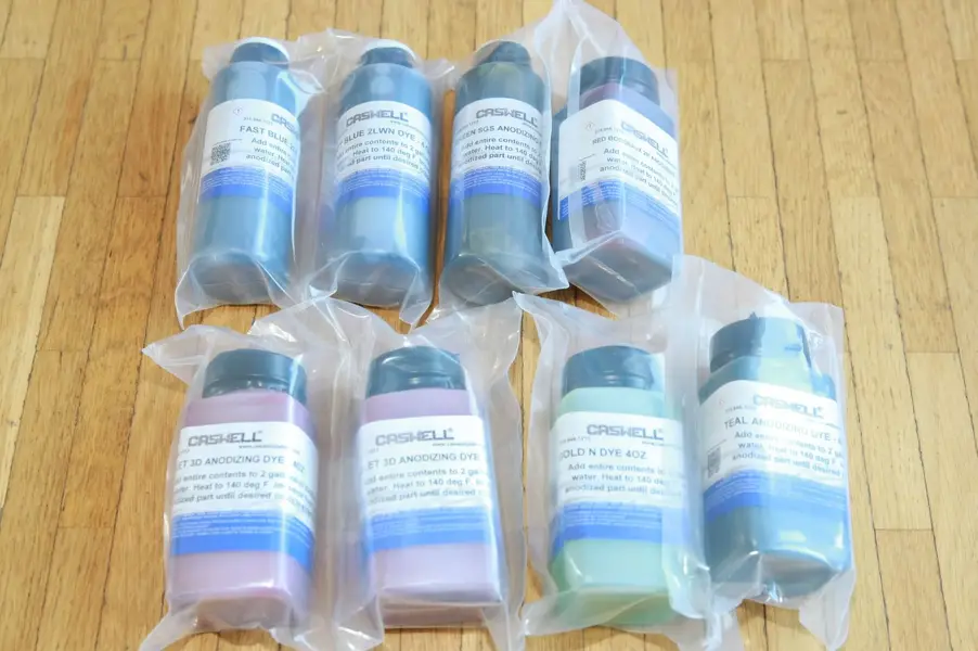

I have Paul Thumbies that are black anodized, so I'll strip them and either dye them green, turquoise or 3dv purple. Haven't decided yet. These are small parts so if I am successful with those, I'll move to these black ano Tech Lite brake levers I have. Success or even being content will progress to redoing a few larger parts for a specific build.

I have no idea if that is his profession. Though if he is or was professionally anodizing, I would be very interested in what he has in his head, i.e. processes and technique. The company Caswell sells various DIY complete kits along with the chemicals and dyes needed. They are one of various businesses out there selling these kits. This leads me to believe that most of the public is competent enough in doing this at their home. I think I'll order the Multi-etch just to spite this thread. :LOL:
