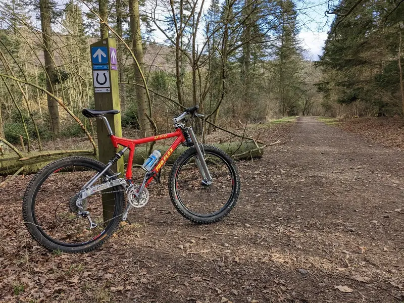

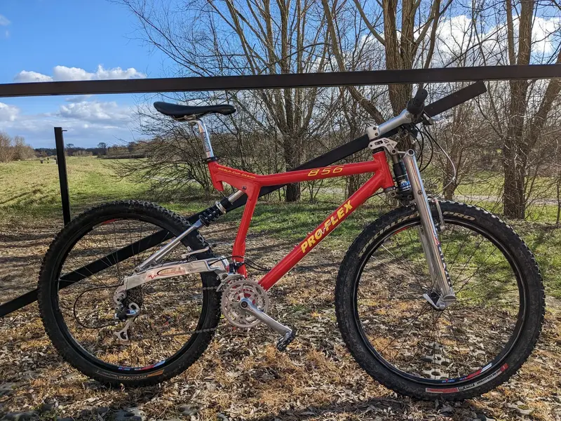

Finished – well, not quite, but finished enough to take it out for a ride (pics below…)

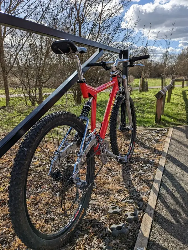

Rear derailleur still needs a bit of tuning to reach full range of movement, but the limit screws are in a bad way and need sorting out or replacing. Managed enough to get movement over everything except the biggest and smallest cog at the back – as I was on a clock I decided that was good enough. Front der working very well though and suspension exceptionally smooth. Nice Ritchey post and Flite also added since last pics.

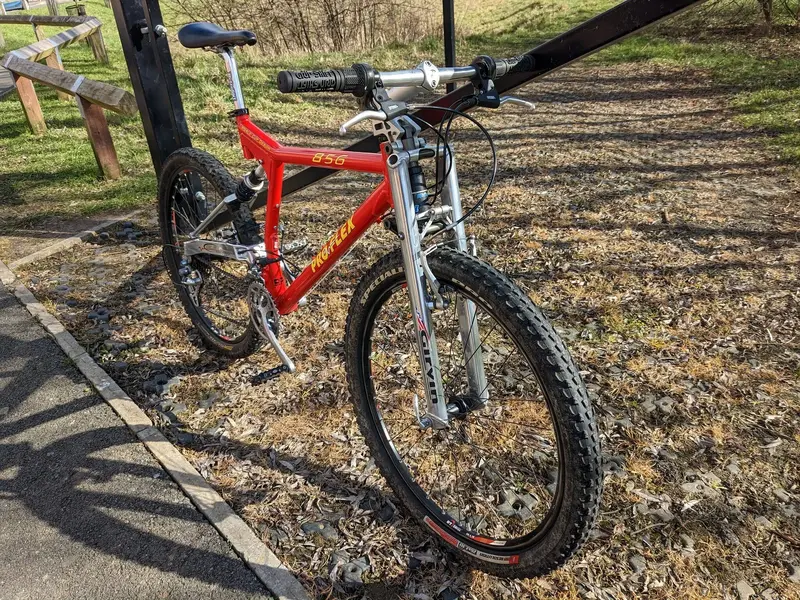

Finishing touches – still undecided on bar ends, but I think I’ll leave them for now until I can find some Girvin ones.
A flexible V brake cable guide is on its way to me, which I’m hoping will allow the cable to run through the frame as intended, which will look neater.
A nicer handlebar could be good…?
And I need to sort out wheels (nudge @raidan73), and possibly tyres, but these will do for now.
Overall very pleased at this, came together nicely and I have a decent amount of original kit on there (X-rays, Proflex stem, Impel chainset) that it feels original enough (wheels excepted). And it works really well. Just a bit more time to get all the gears going, shoes also coming so I can used the SPDs I have, but it rode really nicely around Wendover woods (where the pics below are from). Hope to take it a bit further next time on some more technical trails at Rushmere Country Park.
For now happy to call it a wrap. More pics and spec list in next post…

Great work! Nice choices throughout, silver swingarm/fork with the red and yellow really go well together.
How's the fork perform?
The bike looks great! How was the ride? It looks immaculate, and the black wheels give a sinister appearance. (My recently rebuilt ProFlex is my first experience on a FS mtb, so I'm quite curious to hear your thoughts.)
Regarding the brakes - I believe that the frame was designed for cantilever brakes rather than the V's, so it's not necessary to run the cable thru the seatube. High end models came with Magura which used identical routing to what you have done with your V's. And you're right, there is no clean way to route the cable.
