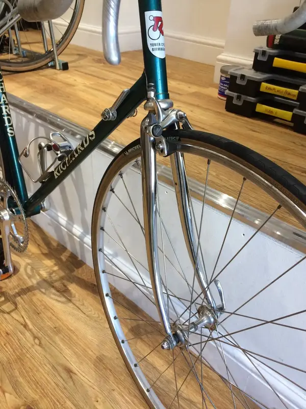

Once again, I spoke too soon, and to continue the theme of going back on my previous plans, I've found someone fairly local to chrome the forks for a decent price (£60 plus VAT) - so I'm going to do that after-all. I had originally aimed to have chrome forks, and obviously that will look a lot better with the frame.
Of course, they have a 3 month waiting list, so it's going to be well into the new year until this FINALLY becomes an actual bike instead of a collection of parts. But one day, one day...in 2021...

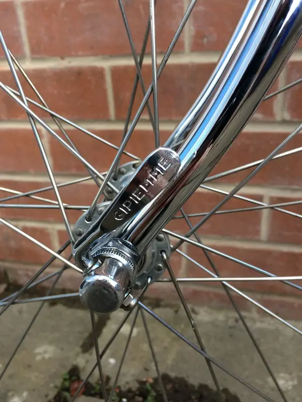

Only 8 months later...well, I did say it would be some time in 2021 that I finally got back to this build.
Anyway, forks chromed and finally installed with a Stronglight A9 headset (which was pleasingly easy to install compared to others I've done in the past).

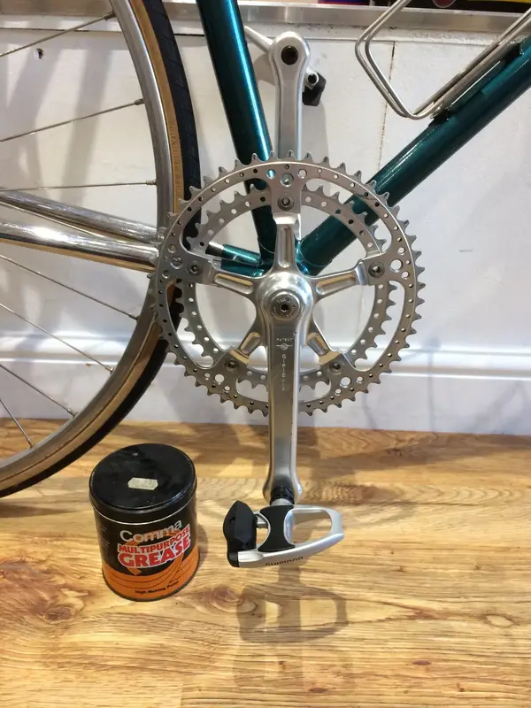

Gipiemme Crono Special chainset installed, with a modern BB and pedals, and I've re-greased the Gipiemme Sprint hubs.
I do need to get another front derailleur, as I have a Campagnolo Gran Sport I was going to use, but despite being the right size, I don't think I can install it without damaging the paint more than I'd like.
Most importantly, I used genuine vintage grease...;)

FINALLY FINISHED. I'll be taking it for a shake-down ride in The Peaks soon. All in it weighs 10.13kg, which is pretty much exactly what my current most regularly used steel bike weighs, though that has a smaller frame. It could easily go under 10kg with a few component changes, but I'm happy with it as it is for now. I'm glad I went for the chromed forks, even though it made this build a lot more expensive.

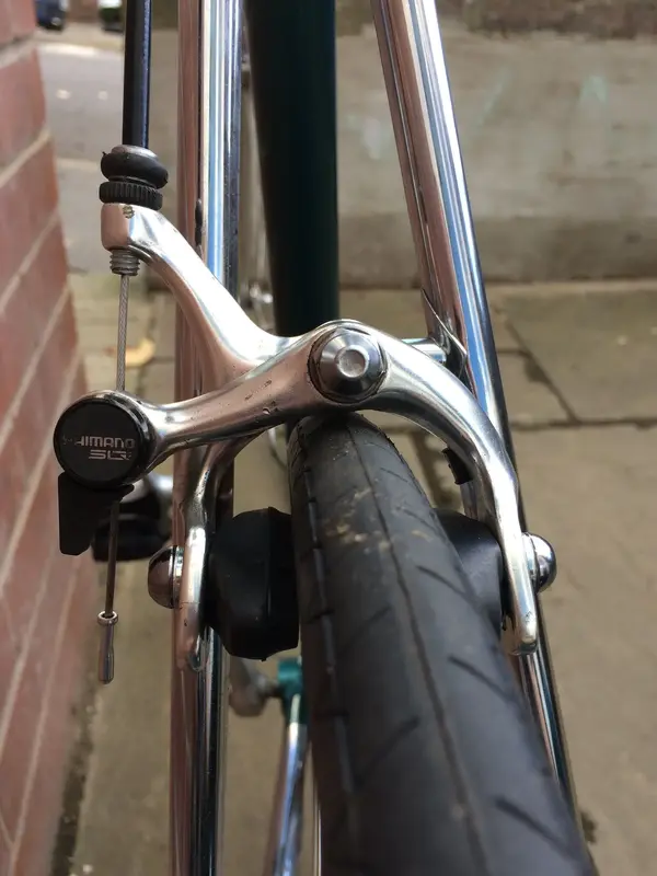

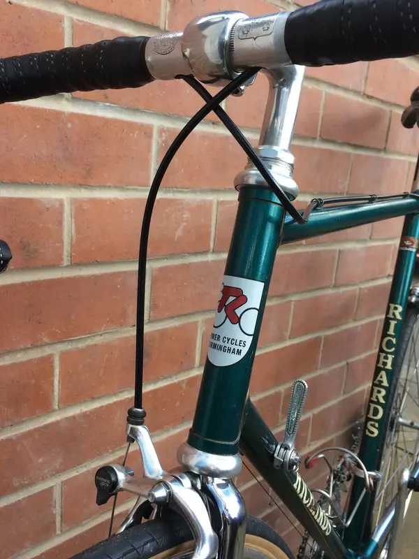

Brake cables routed through the bars which have custom-drilled (not by me) holes. A bit fiddly to do, but some paper-clips came in handy...
Even with a 20c tyre, there's still very little clearance for the rear brake.

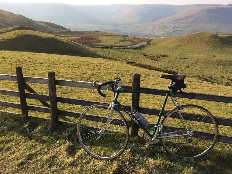

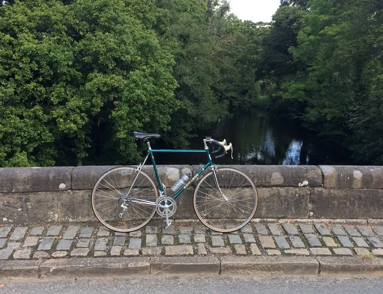

I missed the finished result on this one, great job, looking very smart. Your scenic rides are pretty enviable too. 😁👍
Thanks! Yeah, I'm lucky to have lots of great country roads more or less on my doorstep – some are pretty challenging, hence the low gearing on this bike (though in this particular case I didn't come up the side of the hill pictured, but going down it was interesting enough with non-modern brakes...).
