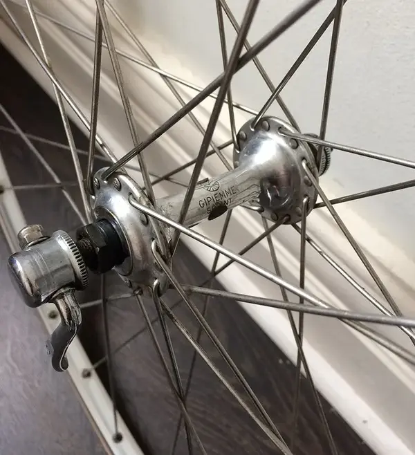

The build has been on hold for a few reasons, one of which being that I got a pair of very dirty Mavic MA2s with Gipiemme Sprint hubs which have cleaned up pretty nicely and hopefully will be the wheels for this build. I need to re-grease the hubs, as they had been sat in a shed for at least about 30 years from what I can tell. The front hub is actually amazingly smooth, considering, but the rear is very 'gritty'. I don't have a 4-notch freewheel remover, so I'm waiting for that to arrive.

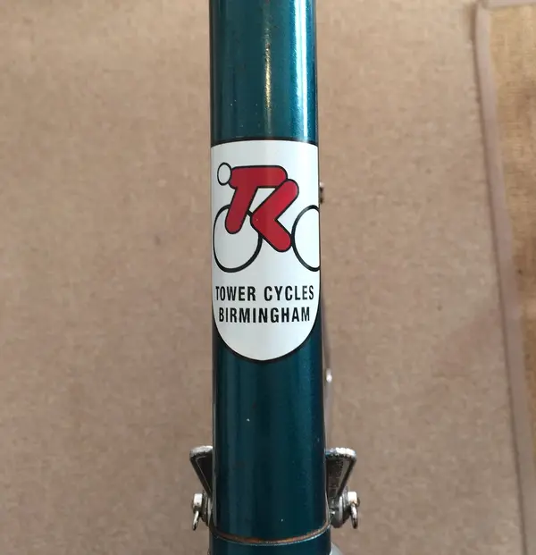

I thought I'd post a photo of the head badge, which is a bit different from the version H Lloyd stocks - though the tube decals they sell are exactly the same as the ones on this frame. The badge decal has obviously seen much better days, but as this is not a full restoration I think I'll keep it as it is - plus there is no exact replacement available without getting a custom one done...

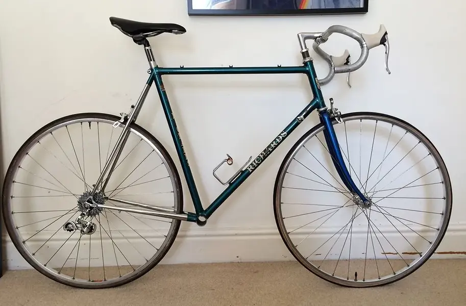

Another long hiatus due to various things, now this build is slowly getting back on track, hopefully. The main issue was that sadly the chromed forks I originally bought did not have a long enough steerer (rookie error, there). Perhaps not unsurprisingly, getting a half-decent chromed fork with a pretty long steerer is not easy, so I've opted for respraying a fork using chrome-effect paint. It's a bit ironic, considering that the fork I got is in very good condition - much better than the frame, but there you go...this was probably always going to be a slightly odd build. Let's see if it will actually look the part once done. Fingers crossed.
I have also got the correct short reach 105 brakes, as I do like their design, and they are in keeping with the mid-80's look (admittedly 1983 is maybe a bit early for aero brake levers, but let's say whoever built this in an alternate 1983 was an early adopter).

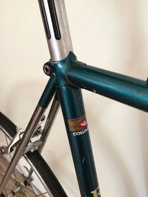

I'm also including a photo of the seat cluster, as this is my favourite style, where the rear stays integrate nicely with the lug.
As it currently is, it weighs 8.2kg, which makes me wonder if the full build could come in under 10kg. Maybe that's being a bit optimistic, we'll see.

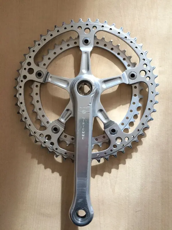

This is still going nowhere fast, but the time has partly been spent deciding whether to actually go down the triple chainset route, and whether to replace the head badge. After much dithering, I couldn't in good conscious put the triple on, so instead I'm using a Gipiemme Crono Special chainset which I originally bought for another build. This matches the wheels nicely, plus is drilled so fits in with the weight-saving idea too. It will definitely look a lot better than the triple I was going to use.
That does mean getting a different BB, and more £ of course...
Slowly getting somewhere. Possibly.

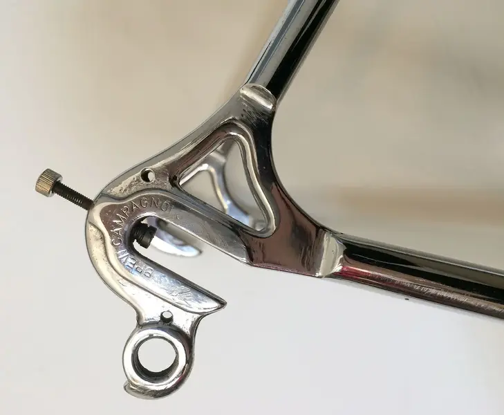

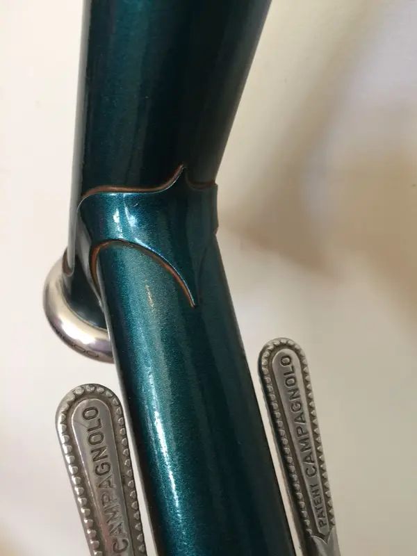

A few more photos of some frame details here, before it finally gets built up.
