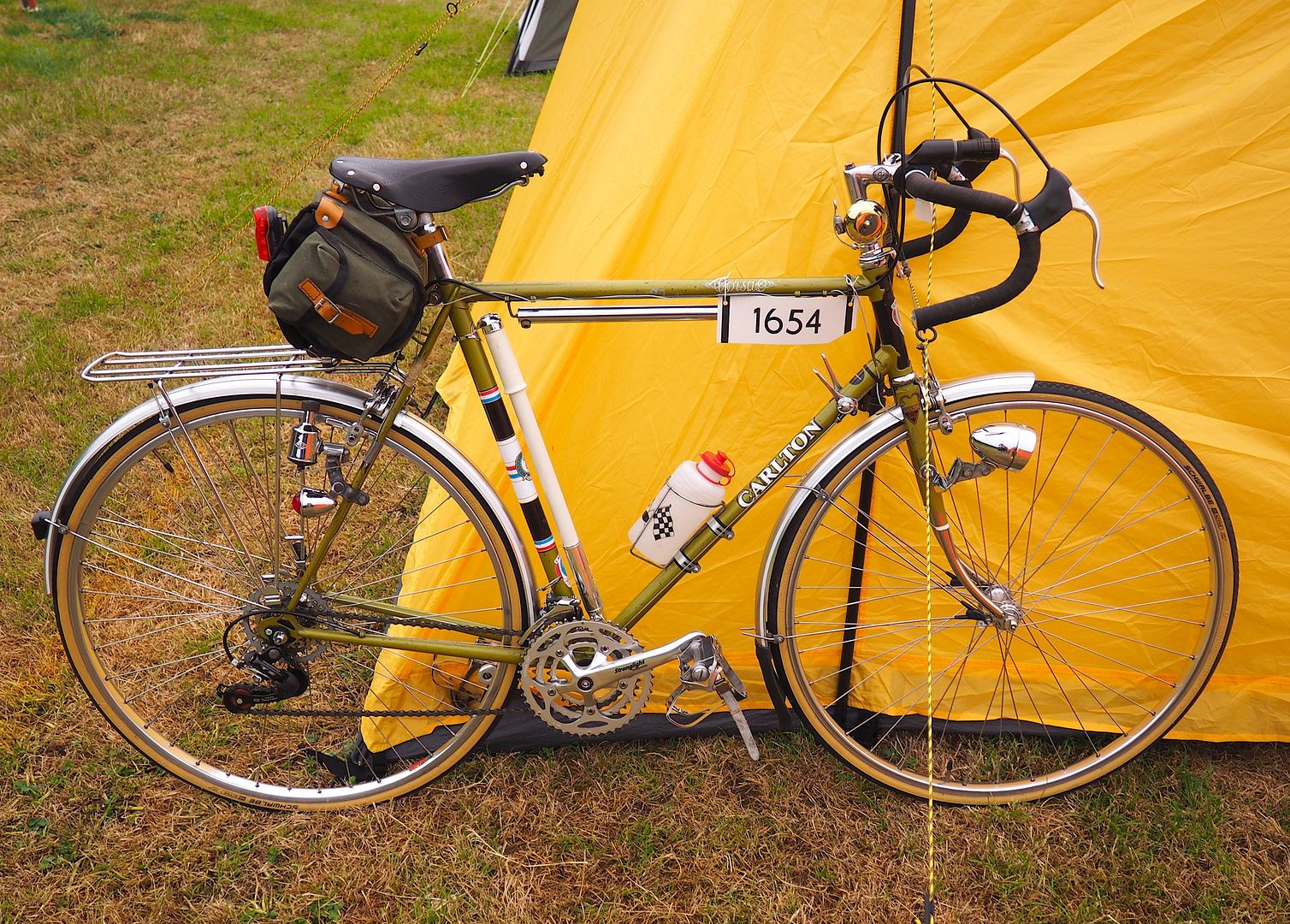

I run a 14-34 rear with a 48/38/28 Stronglight triple on one of my builds - it can tackle any hill.
What rear mech do you use, are you running a cassette for freewheel ?
6 speed freewheel with a Shimano Tourney, Shimano Acera X front mech.
At Eroica this year...
So I could replace my 7 speed 13-28 screw on freewheel with a 14-34, bung on a tourney I have in the shed. I could keep my 52/36 crank. Giving me a 36-34 lowest gear :)
