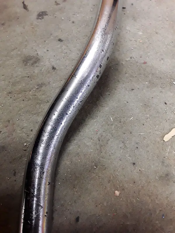

Sadly the bars are beyond saving, the chrome has all but disappeared in the sheep dip...I'm not suprised it was very flaky to start with....see below.
But those being off the menu, has now made me think about other options...including a pair of early nitto bars.

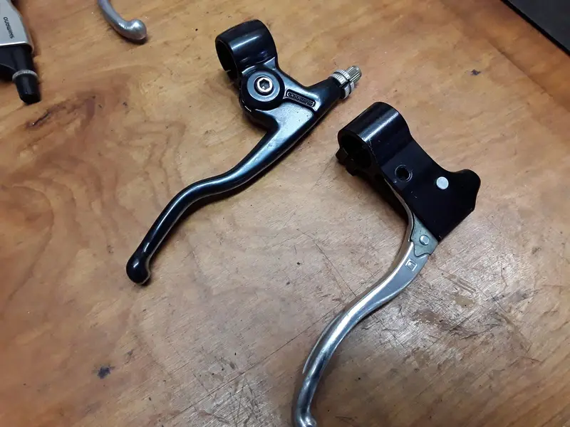

I'm also in two minds as to whether to keep the original brake levers or swap them out for a pair of deerhead ones. The diacompe are original, but the deerhead are much more refined and nicer lever....both are the same era too.
It might come down to aesthetics in the end.
You could get those bars rechromed, but at quite a cost! Some early Nitto bars sound great, but need pics of shape/profile/sweep etc.
Love the difference between the levers. The Deerhead are WAY more refined in everyway, but I really like the clunky/agricultural aesthetic of the Dia-compes, kinda' match the funky (yet clunky!) SA hubs!

I did think about chrome plating it at work, but the metal has rusted under it quite badly and is pitted badly. Im not sure, without professional multi layer and polishing you would get very far. The last set of bars we had done were close to £200 by Vehicle and General in Bedford!
Its such a nasty process, nobody now wants to do 3 pass chrome anymore....pitty as there were 3 in the same area near me 20 years ago and it was dirt cheap!

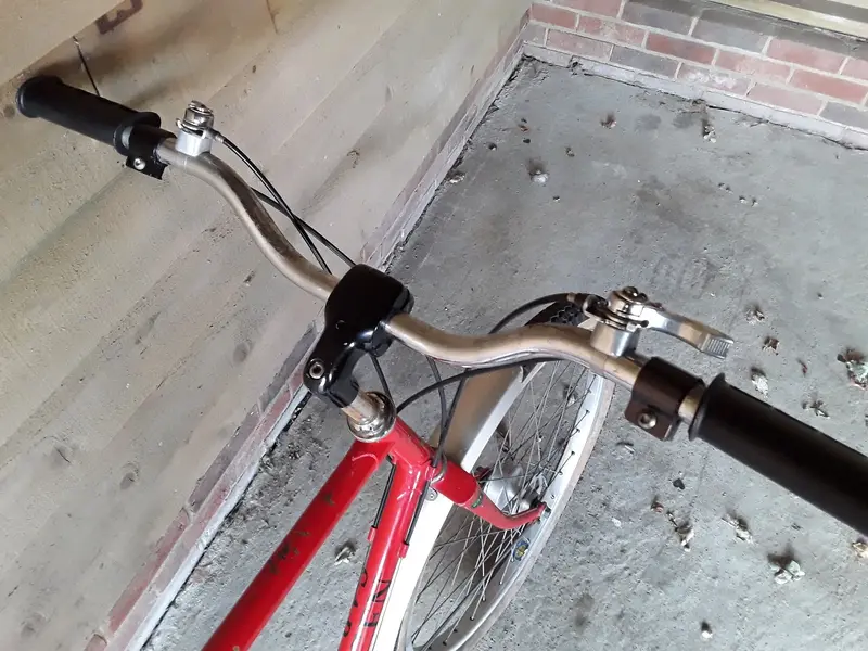

Here are the bars I've decided to use....not exactly original spec, but right age and has the added advantage of makung the bike far more O.R.F.... (old rider friendly). 😂
Plus as they are actually early 80s, they will fit the 22.2 stem clamp.
Bit of paint stripper and a buff up and they are as good as new.....
I love deerhead levers, but those Diacompes look great on that bike.....its a tricky one, but if it were me I'd stick to the diacompes.
