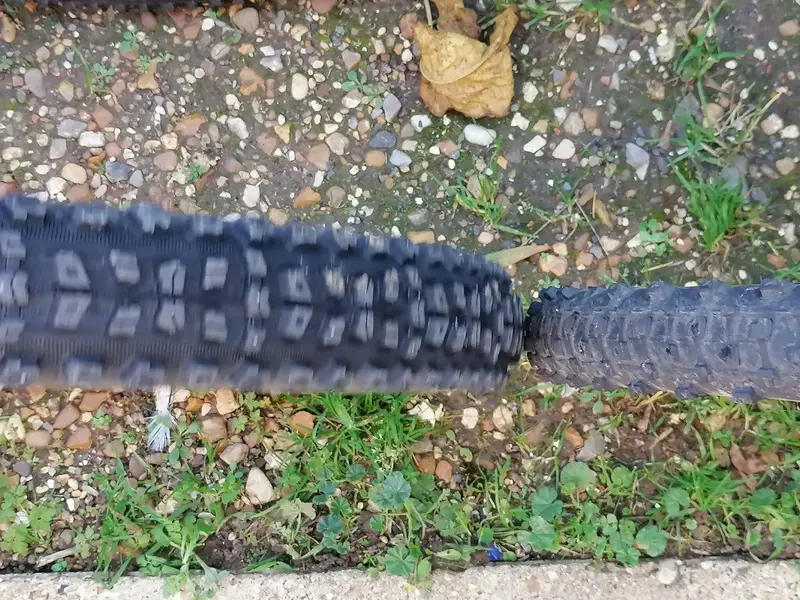

big tires on the old 26 wheels really helps too but there is nothing fundamentally wrong with what we do on our old bikes, its just that it does not fit with the marketing or the sales of new in any shape or form
