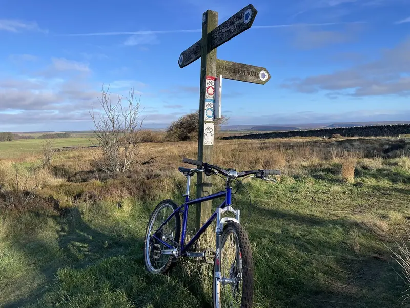

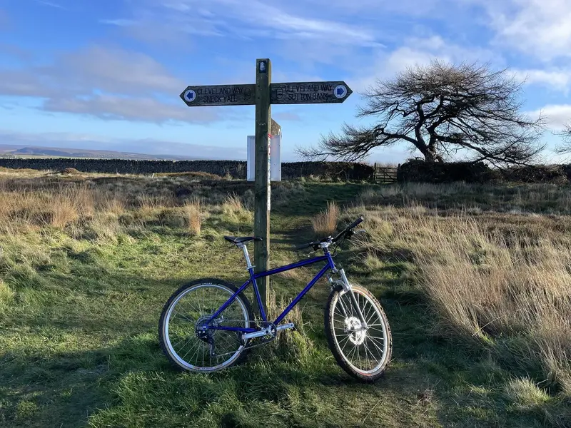

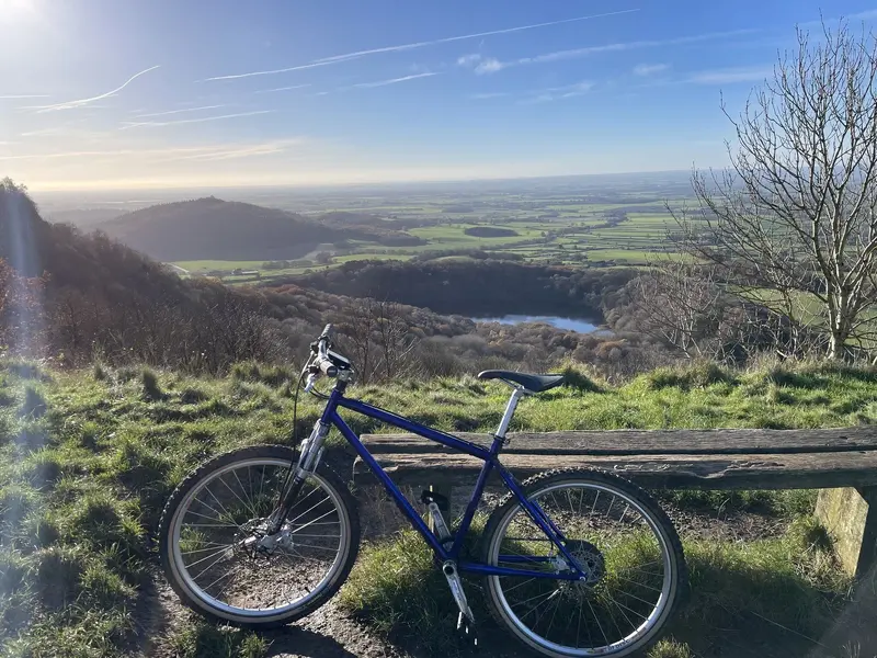

IMG_4665.jpeg IMG_4663.jpeg IMG_4662.jpeg IMG_4669.jpeg I think I accidentally own the best bike in the world (tongue in cheek but you get the idea). I don’t know if it’s because the forks were just fully serviced by Pace and they made an adjustment I’d never found before or the tyre pressures were spot on or because I’ve never ridden a Cinder Cone this hard off road before but wow I can safely say this is the nicest cross country bike I’ve ever ridden. Prior to this I’d have said it was a tie between an m2 stumpjumper or a 2004 Explosif.
I wish I’d bought one 25 years ago, I’m gobsmacked how playful and precise it feels. Some sections today I rode at 9 tenths of my ability and it felt natural and easy.
