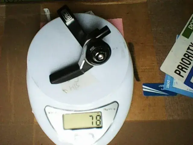

Anyway, some news, the postman bought me a sunrace M90 9 speed thumbie today - interested to see how well it works with the XTR mech... seems well made and looks good on the scales anyway. I really like this build (viewtopic.php?f=6&t=390611), which uses one, and will admit to taking some inspiration from it. Even though this is a pretty different prospect I'm hoping to capture a similar-ish vibe. Been aware of these shifters, and had been thinking about a 1x build for a while, this seems the right bike to do it with, and 9 speed seems a good compromise all round.

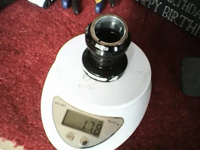

Did some digging in the parts bin, found some stuff to fill the gaps but it's all a bit on the heavy side. I might give this FSA Pig a miss and treat it to a new Orbit MX. Actually I'm tempted to order a super cheap Chinese eBay job - there are some nice looking no-name alloy ones with sealed bearings for about £6, although I think the Orbit is probably lighter (and nicer). I'm sure a Chris King would be even nicer but I can't bring myself to spend that amount of money on a headset...

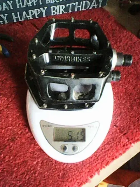

DMR V8 pedals will do for now although there's definite room for weight saving as and when funds allow. At least pedals are easy to change around on a completed build (unlike headsets!)
